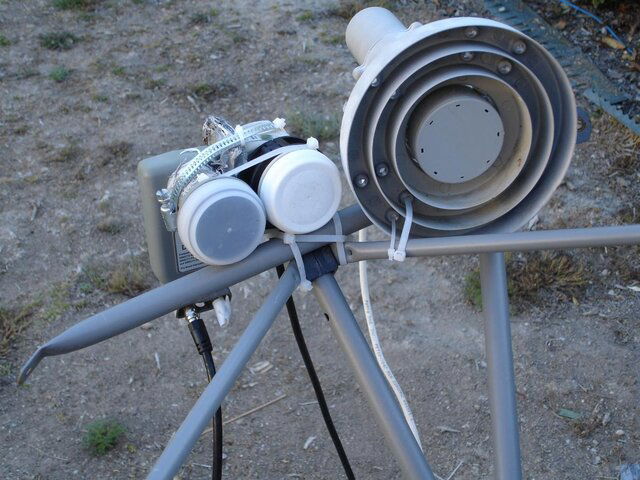

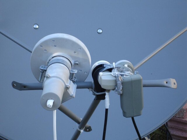

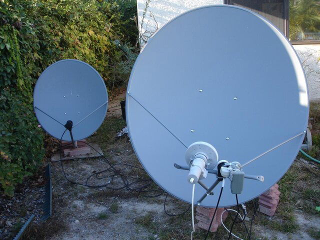

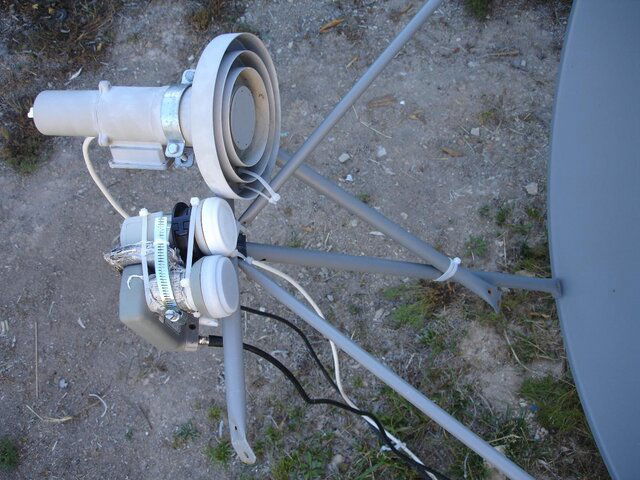

Here's my setup :)
I know it does not look that great, but it works well for me and the tie-wraps have held it in place since June without any problems.
The 1.2 Meter Dish (Large one) is on a motor GS120.
The 36" Dish is pointed at 103 Degrees West due to the weird skew.
Hopefully this might give Brotherhood some ideas.

Question---> Say your dish is pointed at satellite X, so the center lnb is receiving signals from satellite X, are the two lnbs on the left and on the right of the center lnb also receiving signals from satellite X? In other words, can they be angled so they all receive signals from the same satellite?
If the answer is "no", then I assume that the side satellites will see birds a few degress to the left and right (the left lnb sees satellite to the right of center and vice versa). If this is the case, and you have the dish motorized, how do you account for the difference in skew of the dish required for the different satellites? Do you know what I mean?

Unfortunately they can not see the same satellite at the same time:
For a circular bird I have to move the dish to 4 Degrees less than the actually location, example for the 119 I have to move the dish to 115 degrees.
For a C-Band bird I have to move the dish 6 degrees more than the actually location, example for the 91 Degree satellite I have to move to 97 degrees.
So if I point my dish at 100 degrees west:
The Linear would be pointed at 100 degrees west.
The Circular would be pointing at 104 degrees west.
The C-Band would be pointed at 94 degrees west.
I hope that helps a little bit.

As for the skew, I believe that once you tune each LNB for best skew, then as the motor moves it across the arc, it tracks just fine.
Should be able to set each skew on any near-central bird, and be good to go.
