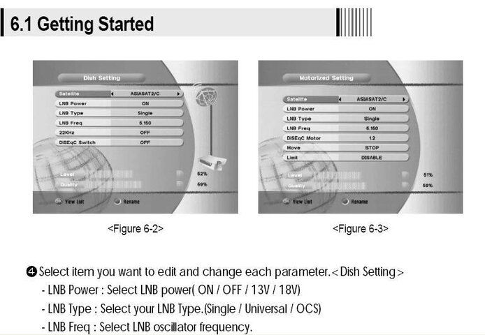

I downloaded what I thought was the manual for the Coolsat 5000 Platinum receiver from this list but it isn't really what I'm looking for. The file I downloaded was titled Coolsat 4k/5k/6k which doesn't seem to apply to my receiver, not even the pictures. I need to figure out how to ADD, DELETE, or RENAME a satellite. For example,
Weird ... I'm looking at the PDF file for the CS-4k-5k-6k manual and the pictures look right to me . ???

... I need to figure out how to ADD, DELETE, or RENAME a satellite....
Main Menu > Installation > Dish Setting > Satellite
Note: In this window you will find < 0.0E---->
You can find this by scrolling to the right using the right arrow button.
Hit the RED button on the remote to edit the name to the new bird. Make sure you enter its position plus the name you want to call it.
This is how you ADD a new SAT. After adding the new bird, do your setup for that bird to get the channels.
To RENAME a bird that is at the correct location, just rename it with the RED button.
To DELETE a SAT, just DELETE all the channels for that bird to make the SAT go away in the channel list.
