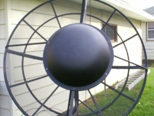

I use the 6' KTI with the ASC-421 C-Band LNBF and LOVE it! It pulls in 95% of the C-Band DVB signals up there!
The dish will also work for KU-Band as the holes are pretty small!
