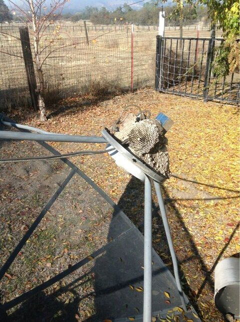

Well, thanks to Toucan again, I now have another 7.5 ft dish. However, it was after sun down when we could get together and I did not do a good job of tying it down in my pickup bed. It started lifting and I had to pullover and stop about 3 times and by the time I got it home, I saw I mangled the struts tying it down, but the mesh is clean and straight. I will replace the struts with 1/2" EMT with the ends flattened. Thought I would show you what I found when I removed the LNB cover. Not a surprise, except for the number of nests. Course the dish must be 20 to 30 years old?

Holy cow! Those nests are huge, I would've hated finding those the hard way. Even with the bee suit I still have, from several years of beekeeping, those would have eaten somebody up.
BTW those suits are no good for wasps either, learned that the tough way too. Wasps have much longer stinger, and it isn't barbed like a honeybee's, so they can sting repeatedly.
And will!
I seen that when I got my last dish. Good thing is was October and not sooner.
I had the honor to get rid of about 15 nests like that where I work 2 month ago. I started out with wasp spray, but the new sprays are not as potent as they used to be and the wasps are still trying to come after you.
I ran out of spray after about 4 nests, so I used a 10 foot EMT pipe.
You hit the nest down, then throw the pipe to ground and run. Works very good and I got all of the nests in a very short time. Most of the nests looked like that in the picture.
It is to bad, you can not this with LNB/LNBF setup like that.
No live wasps. Been dead quite awhile. But there must have been a gazillion in there at once at one time! Got the struts made today. Pictures tomorrow. I will replace the LNB with a LNBF. I may hang it on my existing five ft solid metal c band. Has the same polar mount.
Starting fluid kills the live critters dead instantly. Learned that trick from an old farmer that I got an 8 footer from.
Sent from my Xoom using Tapatalk 2
That doesn't sound like it gets me far enough away.... When dealing with wasps, I buy the 25 ft spray cans at LOWES hardware by the gross. I always have at least 3 or 4 cans on hand to spray them here. I have more than my share of the little rascals...
If the nest is in the open it seems that you can spray a heavy stream of water at them and they won't retaliate. I remember when a man tore down an old farmhouse for a friend, he waited for a rainy day, because he said those little buggers would otherwise come after him in the cab of the excavator. Might be an old contractor's tale, recounted here for what it is worth.

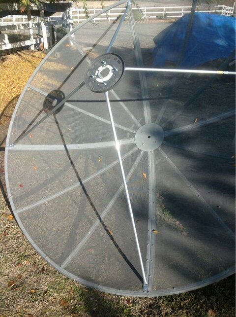

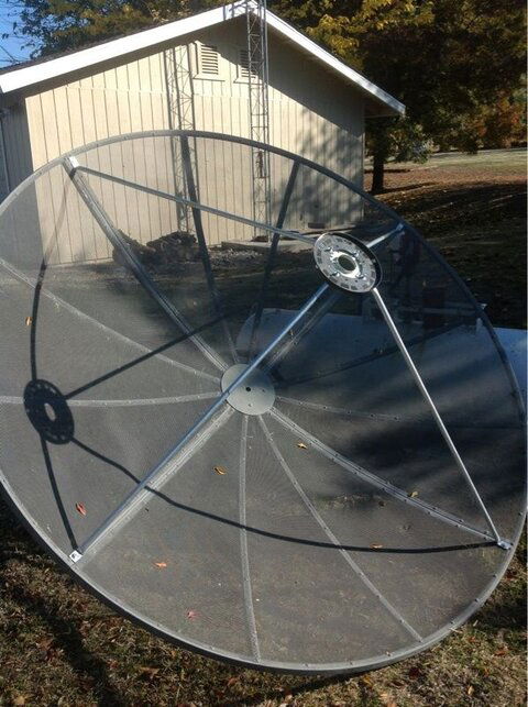

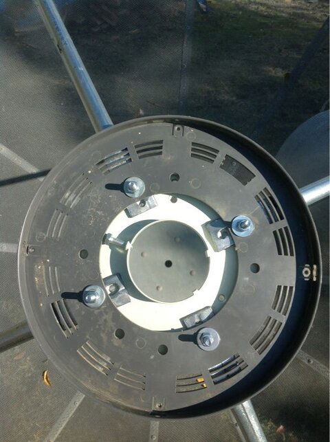

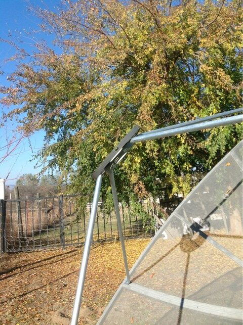

Okay. Struts made out of 1/2" EMT cut to 48" lengths and ends flattened, bent and drilled to the exact same length and angle as the original struts I mangled hauling it home. New bolts and new plate for the LNBF, but I used the old plate for the LNB cover which fits nicely. I took time ensuring all four struts meet the plate at the same dimension, so am hoping the plate is centered; looks okay to the naked eye, but I know measurements are always the proof. I may spray paint the four struts, but I hate to paint the galvanized EMT. Guess it doesn't matter.

Okay. Struts made out of 1/2" EMT cut to 48" lengths and ends flattened, bent and drilled ...
