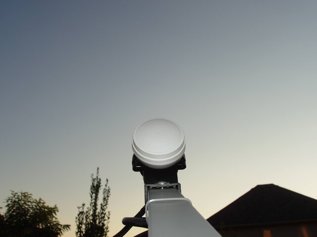

1. Make sure the LNB is in the cradle as far from the dish as possible...makes a signal quality difference of about 40% (it did for me, at least);

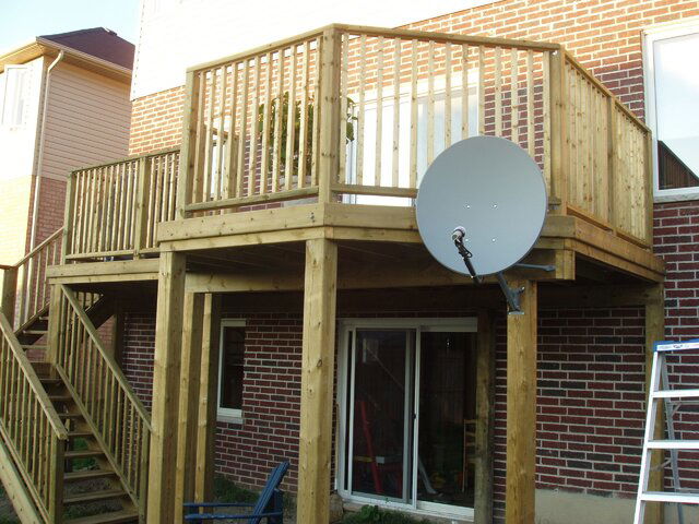

Finally, I mounted the dish just where I wanted it - it really blends in - but I could not get a lock on G10r no matter what. I live way up in the icy Canadian tundra of London, Ontario (43N, 81W), and I started to think I was not going to be able to get a FTA signal. I bought a satellite meter, and could tell there was something out there, but the Vistar is really not a good receiver for newbies, since you program it and then it tells you if you have a good dish alignment...instead of pointing the dish and having the receiver do the thinking.

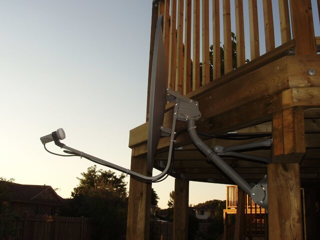

I've included some pics of my setup. I hope they help others get into the hobby. One thing to note is the elevation of my dish. The calcs on the net all said I should set it to about 25. But you will notice its set around 35...which is a pretty big difference. Maybe that has something to do with how far above sea level you are...I dunno. Just something to keep in mind.

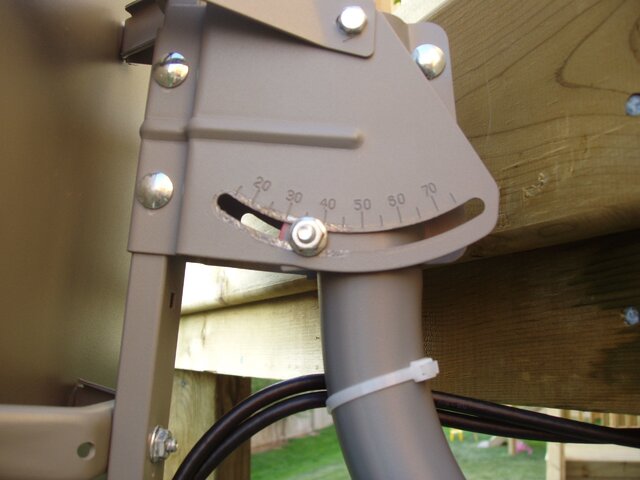

actually its how far north you are, which is weird because for G10 my elevation is about 30 on my dishes. (and I'm at 45N 93W)

That's very interesting about the elevation. I guess its possible my mount is not plumb. I thought I got it spot on, but who knows?
Some elevation mounts were goofed so they are off. I have a Fortec dish that is off by about 5 degrees for some odd reason.
