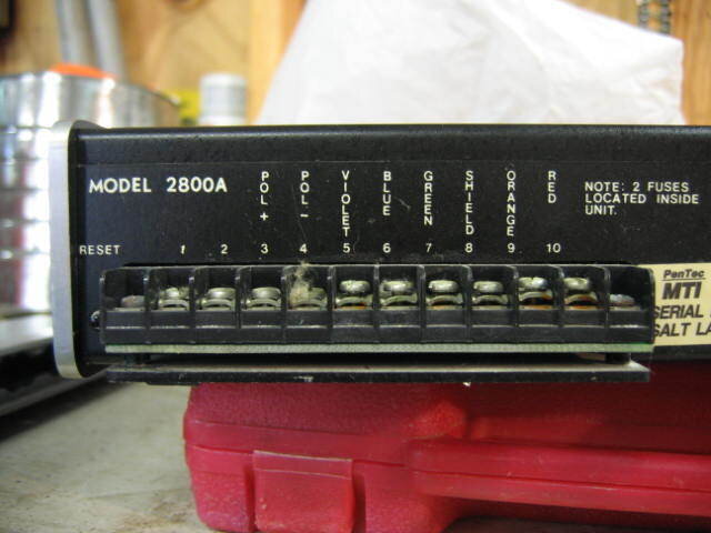

The actuator is a four wire, I understand two are power and two are sensor. First question, I don't have a receiver yet that will move the dish, however I DO have a standalone dish positioner box, a MTI 2800a. I have posted a picture of the back of it below...how do I hook it to the actuator?

most are marked m1 and m2 for the main power wires red & white these are the only wires to roughly move the dish the smaller wires ( some are green orange black brown) are for the sensor

Actuator works! I hooked up the old MTI box, pressed up button, and off it went! I didn't try to figure out the sensor wires, just ran the motor. The Chaparral has an Eagle aspen 25 dgeree LNB on it. Its C-band only, too. The extra coax was just cut off. Having an analog box on it is gonna be a pain because i am going to have to run a new conduit for the polarotor and the actuator. Although it wouldn't be a bad idea to have analog available, would it?:confused:

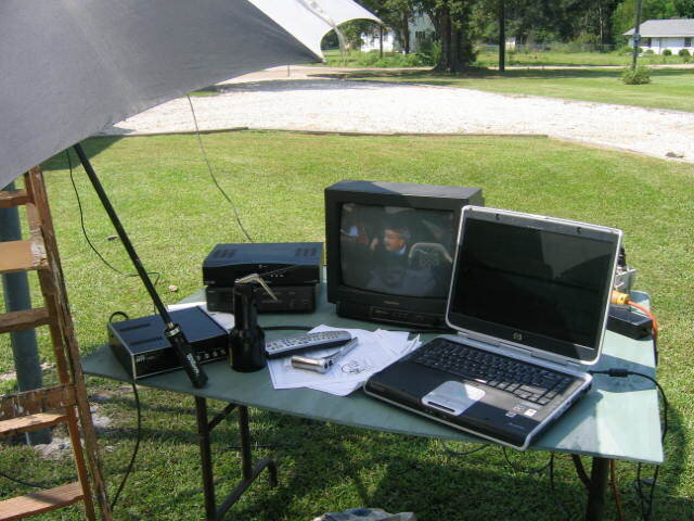

I was ready to tune Tokyo, fellas, check it out.
I am getting ready to go back out and try to figure out what wires I want to put in the conduit, I am thinking two coaxes, actuator wire, and polarotor wire. I have all of it might as well put it in there...
Chances are that eventually I am going to swap the feed out to a BSC621 ( that I already have here right next to me ) So I will not need the polarotor wires but I am going to put them in there anyway. I will need to split the coax out of the LNB to send it to my FTA disecq switch too, have to make sure I have a 2ghz splitter for that...am I missing anything?

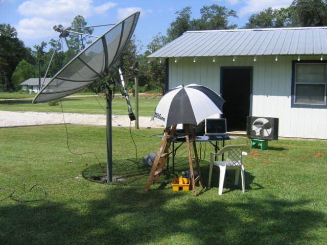

I don't know why, but I never thought about an umbrella. Might have to give that a try, though usually I am sitting on a bucket directly under the dish and get a little shade from the dish. :cool:
Fred
Fred
Fred, if you lived in South Louisiana in August, believe me, you would think of anything to help with the heat. I had to shut it down and go inside about 12, just too hot.
I've been in my shed all afternoon taping wires together to pull in the conduit early tomorrow morning.:)
If it is hotter than 150F like on my black tar roof with the humidity we normally get around here, it must be hot!! :D
Fred
Fred
You got me there brother, 95 degrees doesn't seem so hot when I think of a hot tar roof...I've spent some time on roofs in my time, not fun.
But you have a great place to put dishes, I'll give you that. :up
The long range forecast here has next Friday and Saturday with lows of 58 and highs of 82.
I am so looking forward to a couple of mornings on the roof. :)
Right now, if I have anything to do, I have to get up there about 6:00 AM when it is light enough to see, and down by 8:00 or it gets too hot.
Fred
Nice pictures Stogie. Nice equipment in your control room too. Only thing I can think of right now that you might need, is an Air Conditioner. Then you would have most of what you need?
Al

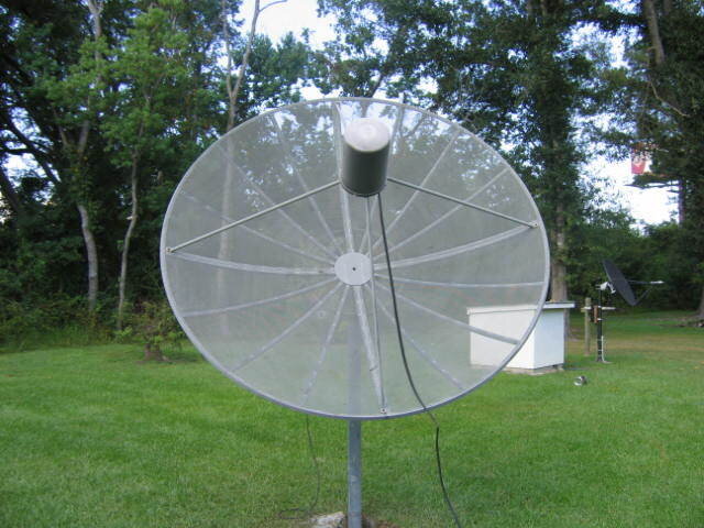

what is this?
Dual C-band Chap Feedhorn
