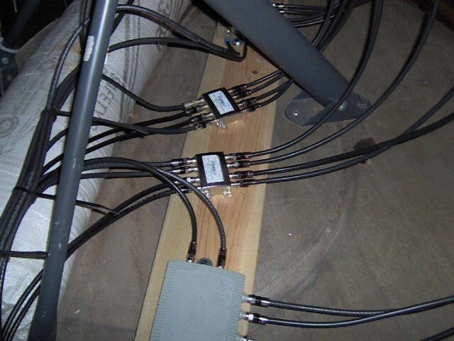

In the below picture are a couple of 4x4 multiswitches. The cables on the left are from 4 dual LNB's and the 4 on the right go to a couple diseqc switches. So each LNB would have both a diseqc port and 22k setting
1st LNB would be port 1 22k off
2nd LNB would be port 1 22k on
3rd LNB would be port 2 22k off
and so on
