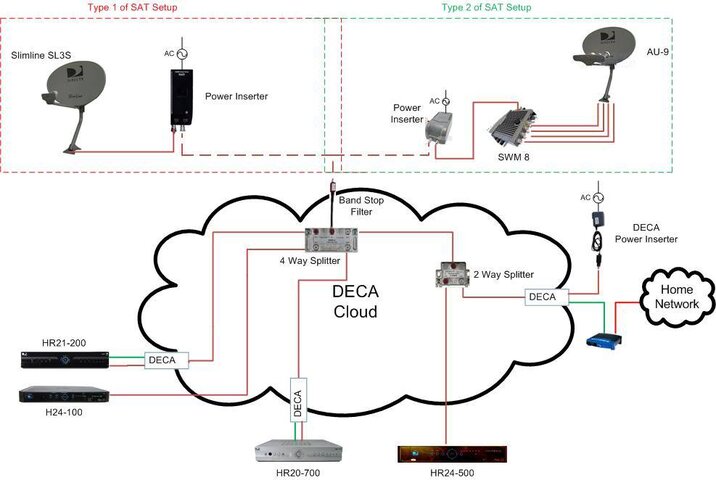

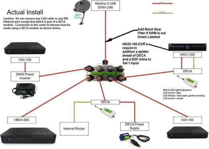

Do these diagrams help? Notice they differ based on hardware types
If he's using DECA for MRV he will need a DECA attached to his router. A lot of people are not using DECA and the can hook up to the router via ethernet.
You also need to remember that if you plug in the ethernet to an HR24 or H24 you will disable the deca and kill your MRV (if using DECA for MRV). If you are using DECA you must have an extra DECA and power adapter to connect to your internet connection.
