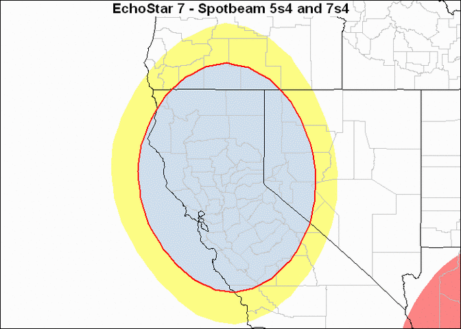

San Francisco's HD is on 119 spotbeam transponder 7. Make sure you can get signal from this first. I've attached the approx. coverage area.
Thanks. It looks like I probably fall outside that area. Isn't Los Angeles a conus broadcast? I could do that instead, I guess. Where would I find the nifty graphics showing the approximate coverage areas?

I checked my signal strength, and the 119 TP 13 is about 65-67. 119 TP 7 is 25-26. So I am able to receive it, but is the low strength going to affect the reception?
I'm located in the Santa Barbara/Santa Maria/San Luis Obispo area. According to the diagram provided by digi, I appear to be right on the edge of the southern most yellow region. This probably explains the low signal reception.
I wouldn't go with that market. Pick one off of 129, like Los Angeles on 129 TP 10. Check that signal.
