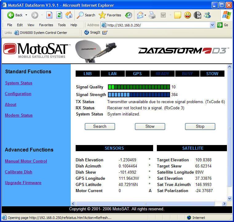

Have you downloaded the owners manual? Here is a copy of the D3 http://www.motosat.com/downloads/internet/documents/operations/D3_Manual_Ver_391_062107.pdf Use either the D3 front buttons to deploy and search for a specific satellite or use the very slick computer control via the LAN connection with the default IP address: 192.168.0.250
