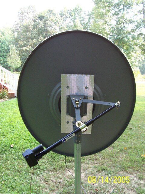

Sounds like this is what you need.
It sounds like you kind of built it yourself but this motor is supposed to be built to take the weight. A few guys here have motorized these larger dishes, maybe they'll chime in.
My 5' dish (160cm) uses a polar mount / actuator which I know some of these same guys have gone to.
Check this out -
