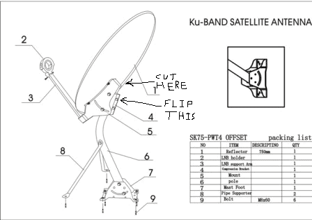

I recently got tired of hearing about feeds on satellites that I wasn't aimed at, so I decided I'd motorize my 30" dish, which only had room for LNBs for 91W, 97W, and 101W. I saw that Sadoun had the Powertech DG-280 on sale on ebay, and it sounded like a decent motor, so I bought one. I got it yesterday and I was going to install it today. I immediately ran into a problem, in that the mount on my dish for some reason was only designed to accept a pole from below rather than above! Here it is, it was the cheapest 30" dish I could find when I bought it last year. I should've spent just a few more dollars and got a known name instead of going to an ebay dealer...
http://www.skytechusa.com/images/skytech/SK75-PWT4sm.jpg
It might not be obvious from the small picture, but the top of the bracket that holds the reflector has a flat piece of metal from one side to the other, so there's no way to get the motor tube in there from the top. (It's sort of like the bracket on a Dish 300.) I considered mounting the dish upside-down, but it turns out that my pole is too close to the ground for that.

i would try to cut a U shaped spot out of the top of the dish bracket, and flip the pole bracket upside down so the bolt at the top doesn't get in the way.
I don't think the bolt at the top is an issue, there are holes in my motor tube for just such a thing, plus I think flipping it would throw off the elevation scale. I don't think the elevation bolts are in line with the bolt at the top as it appears in the picture.
That still leaves me with dysfunctional elevation bolts though. I haven't figured out a way to deal with those yet.
yeah, the elevation number scale would be useless afterward, but you could still adjust it out.
but if the motor tube has holes in the right spot, i guess that solves that problem much easier:)

You can try mounting the dish upside down and see if the elevation is still in range. otherwise you'll have to trim some metal, you can also try eliminating the post clamp and fab short extensions (side plates) to clear the top bridge of the bracket and bolt directly to the motor post but you'll need to be accurate in any calculations when drilling holes. Where there's a will there's a way, just McGuyver it :D don't butcher it!
This is not my week!
I borrowed a reciprocating saw from a neighbor and cut out the offending piece of metal on the top of the bracket.
Guess what? It still doesn't work. When the elevation scale on the dish is set to the proper declination value for my latitude and this motor, the dish hits the top of the motor housing!
I think I'm going to be buying a new dish, rather than wasting anymore time trying to modify this one. I just wish that this one had come with a warning that you can't use it with a motor, I might've not wasted my money on it.
Jim,
The dish that you have will not fit on any motor for that matter, unfortunately. The bracket on it is designed for fixed stationary installations.
