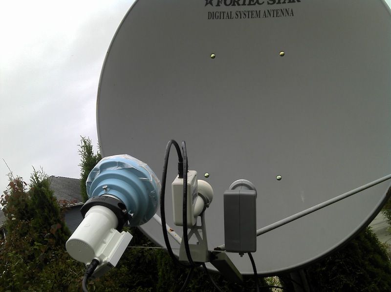

I'm using a STABHH120. It is slow(ish), but super quiet and always been reliable (2+ years). I have it moving a Fortec 1.2 with a ku, circular ku, and a cband on board. I'm really happy with my mini-bud.

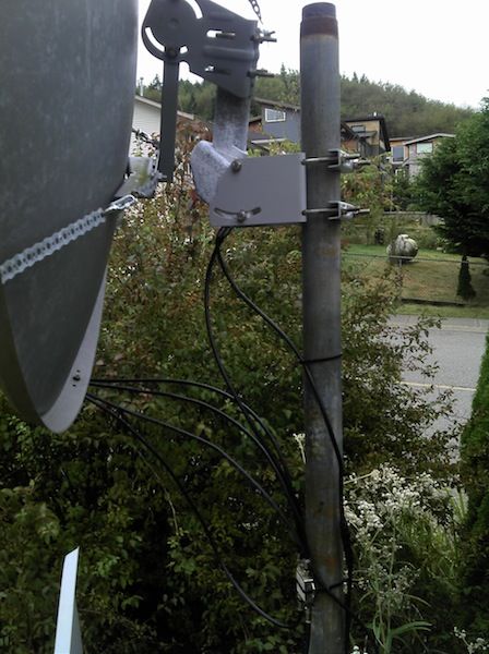

Here it is - definitely a few mods in the last 6 years. I am very happy with it, but a different model - like a GeoSatPro or Winegard would probably be less modding to gain stability and strength.

In my case, I found the cband LNBF works very well as a sidecar in any weather. I lost the weakest Ku - like FSTV or NBC (not skewed) - in bad weather when the Ku was in sidecar position.
Pacific....is that a WSI conical scalar w/ A Titanium cband lnb? What am a missing here...the motor is upside down.

The STAB motors are upsidedown relative to other makes. Yes, the conical came from a DMSI BSC421 that the Titanium replaced.
Not long to find the sweet spot but I have a Superbuddy meter and that helps a lot. I don't recommend using a sat box to point and peak unless thats your only option. A cheap meter like a First Strike is better than a STB.
I moved the dish to a spot about 8 degrees past the sat I wanted( in this case I used the PR mux at 99w so I set my dish to 107w)- put the conical scalar at the end of the tube, set my meter to and slowly waved the LNBF around and looked for a lock. Once I knew where the LNBF was going to be mounted, then it was a matter of fine tuning and changing sats to see if the sweet spot was the same or close for all of the sats I wanted. I wanted Classic Arts, so I fine tuned for that and nothing else got worse. In the end the conical scalar ended up all the way back instead of the end of the tube.
I also have the STAB 120 and that's they way they are, shaft points straight up. I thinks it's easier to work with it that way. Very good motor. Survived many of brutal winters here in the northland.
The Stab HH100 I have points up too. I believe the HH90 points downward when installed. Agree with rsmithwi, much easier to install and adjust with shaft facing upwards.
Yes, the HH90 points down. As well as the HH120 I mentioned above, I have a Hotdish 90 on an HH90.
