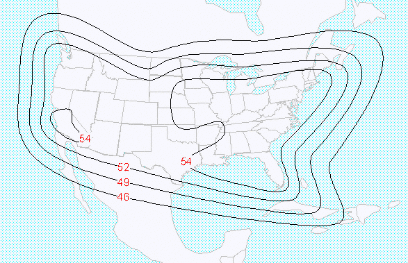

Here is a better footprint of 101w and the dish size needed increases as you go south.
54 EIRP needs a 46cm dish a.k.a 18"
50 EIRP needs a 55cm dish. aka 1.8 foot
49 EIRP needs a 60cm dish. aka 1.9 foot
48 EIRP needs a 65cm dish. aka 2.1 foot
47 EIRP needs a 72cm dish. aka 2.3 foot
46 EIRP needs a 77cm dish. aka 2.52 foot
44 EIRP needs a 95cm dish. aka 3.1 foot
42 EIRP needs a 115cm dish. aka 3.7 foott
40 EIRP needs a 138cm dish.aka 4.5 foot
38 EIRP needs a 175cm dish aka 5.7foot
