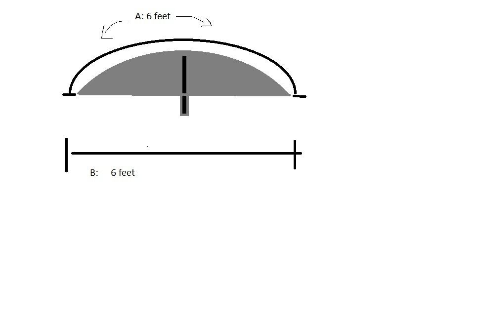

Are dishes measured by lenght or by diameter?
...and if there is a rolled edge, it's more honest to measure inside the lip, before the roll.
After all, a rolled edge isn't exactly reflecting signal to your LNB. :)

For those who aren't just laughing, a "round" offset dish is measured by its width.
And to the offset LNBF, it looks to be the same height as width. (perfectly round)
Elliptical offset dishes need to have their (larger) width as well as their (smaller) height listed.
As long as they use a matching feedhorn that fully illuminates the dish, their beamwidth will be similar to a round dish of equal width.
Mine is eliptical, but the height is the larger dimension. Does that make it equivalent to a round dish equal to my height dimension? Although the LNB is a conventional universal type obtained separately and not designed specifically for use with this dish.
No, your dish is "round". . . When viewed by the LNBF.
Take out the LNBF and sight through the hole at the dish: Round! ;)
And so a common round feedhorn matches the dish perfectly. :up
Yes the dish is physically taller, but when you view it from an angle, it looks round.
Benefits: Vertical elliptical shape attenuates ground noise, Horizontal axis attenuates adjacent satellite interference.
