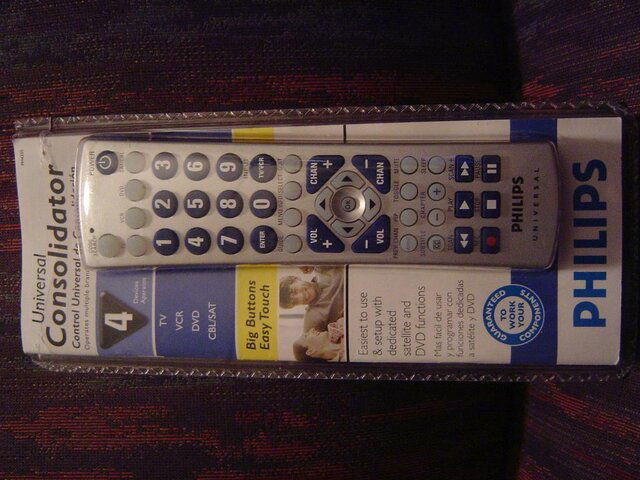

I have a few of these Manhanttan receivers and IMO the factory remotes are junk so I found a universal that works very nicely and navigates the menu setup perfectly. This remote has the 'Device Code Search' mode for unlisted devices. I found 2 of these on eBay a couple of years ago, there may be some of these available or I'm sure there's other remotes that will work.
Here's a photo for your convenience, there's no model number on these remotes so you'll have to shop by the name 'Philips Universal Consolidator' The code for this receiver is "0157"
Good luck

I found the model # to this remote, it's PM435S and there's plenty available online for around $10 bucks. It also has the Device Code Identifier, this is how I found the code 0157 which is used on a number of satellite stb's.

If I were you I wouldn't flash your Manhattan stb with any firmware that is not confirmed or recommended to work with it because you may just trash it. Just get the remote I posted and you'll be on your way. :D

got one and it works great!!!:D thanks man!!:)
