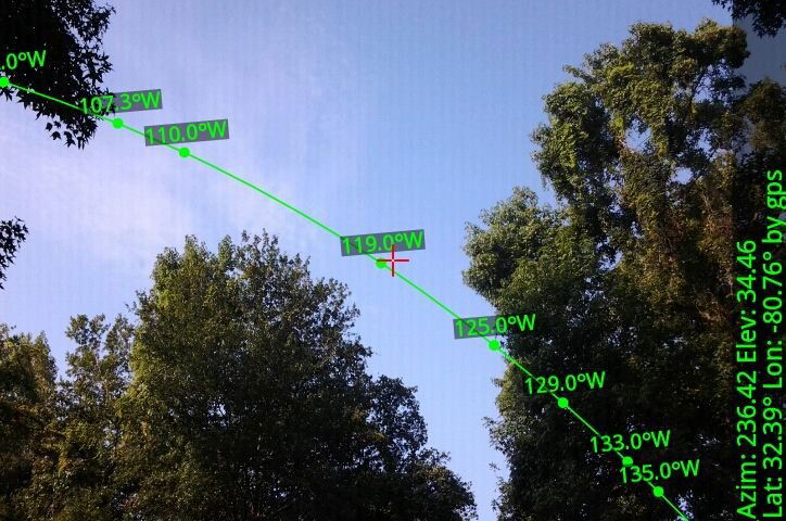

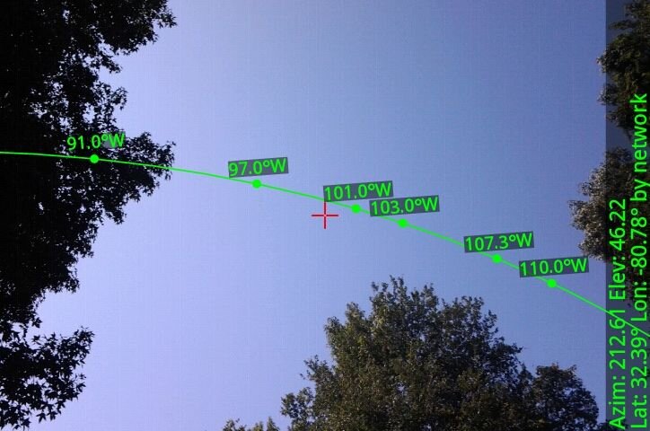

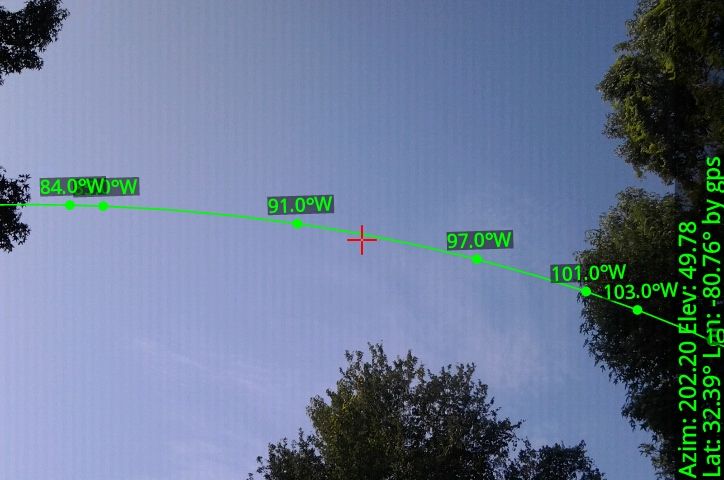

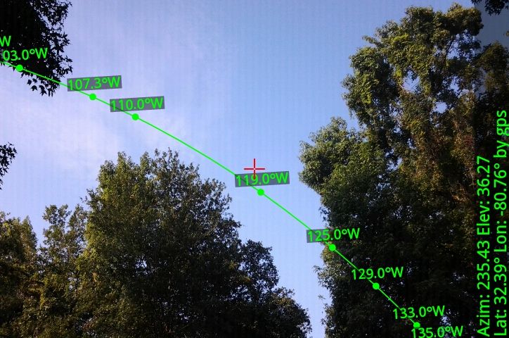

So after alot of research i've come to believe that we may have a big problem with the line of sight .
I used dish pointer.com,and my location is :
Latitude: 32.3921°
Longitude: -80.7642°
Not too sure what dish sat to select in the drop down menu, but we have some pretty tall trees in the LOS.
Also used a driod app (snap finder lite) and took a few snaps :
SatFinder_2014-08-20-08-50-47.jpg SatFinder_2014-08-20-08-50-50.jpg SatFinder_2014-08-20-08-51-20.jpg SatFinder_2014-08-20-08-58-13.jpg

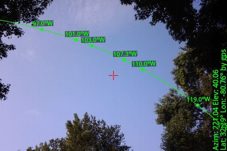

Used the info you gave me and managed to get a better picture.
Hopefully we shouldnt have a problem ( fingers crossed )
:welcome to Satelliteguys jben04!
It looks like you are in the Savannah dma. If so, your local sd channels come from the 119 satellite, which looks like you have an issue with. The local hd channels come mostly from 99, with one coming from 103. The problem is that Directv requires reception from 119 if your local sd channels come from there, whether or not you want or care about them. You may get an independent installer to use equipment that doesn't need the 119 satellite. You should start with scheduling an install. Directv will come out and survey the site to see if there is a spot where you can get all of the satellites. If not, then you may need to call the independent guy.

little update,,a bumped into a direcTV tech .and he check out our area, only one place we can get all the necessary channels, but we will first need to cut down some tree limbs (one being pretty high up).
