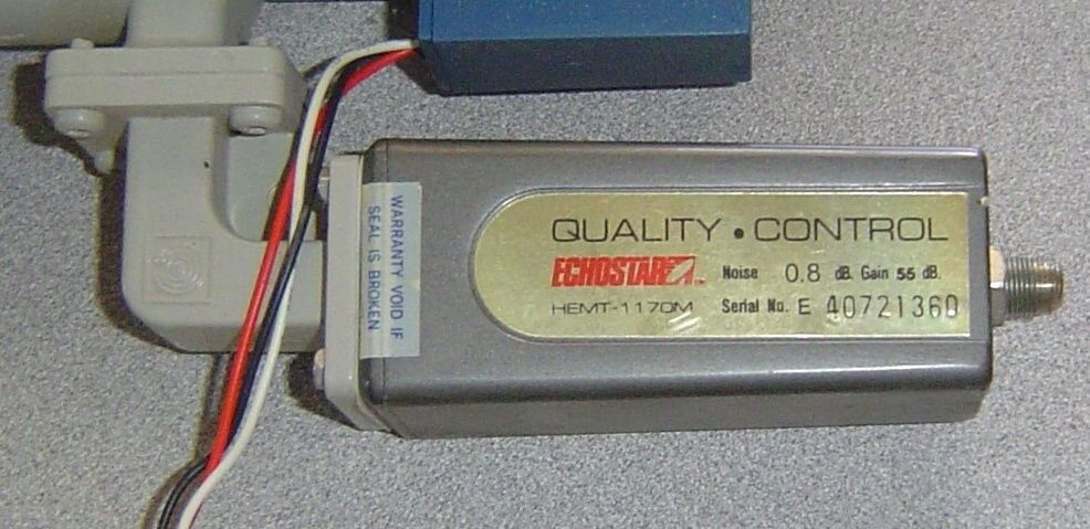

It also came with what I think is at least one outstanding LNB.
On my setup currently, I have a Chaparral 20K C-Band LNB, and an Eagle Aspen .6db Ku LNB.
I got a Norsat C-Band LNB, and an Echostar LNB with the dish today already installed on a Co-Rotor.
I also have some other LNBs that I got from the former satellite dealer's wife a while back.

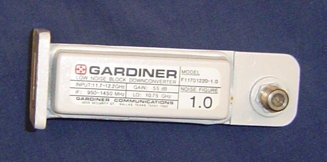

Here are some pics of the LNBs to choose from. Remember, I am trying to squeeze the last drop of signal out of this 7.5 foot dish.
I am thinking about switching out the whole Co-Rotor, and perhaps making some changes in the LNBS.

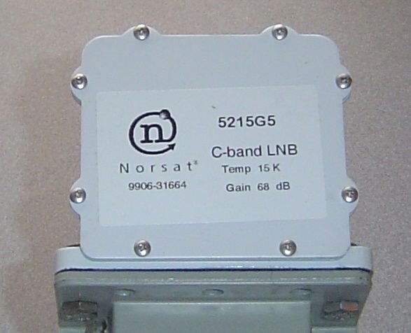

Is the Norsat you see above, that much better than the Chaparral 20K I already have?
Which of the Ku LNBs do you think I should use, the Eagle Aspen that I have currently installed, the Echostar you see pictured, or the Gardiner you see pictured?
All opinions and comments would be appreciated.

I just talked to Norsat, and the guy in support said that it was considered a model 5215 consumer quality LNB.
He says he has one just like it that has been on his dish since 1989. It has a LO stability of + or - 900 Mhz.
So I guess I will give it a shot over my Chaparral.

I can't find much info on the Echostar or the Gardiner Ku LNBs above.
I already tried one of the low stability LNBs I got from you a while back, and the Eagle Aspen seemed to just as good a job as the low stab ones did.
I'm hoping someone will have some info on these other two Ku LNBs.

Didn't get much response, so I did my own experiment.
I had asked about the LNBs above and which one was best, but after getting on the roof yesterday afternoon, I discovered that I had swapped the Eagle Aspen out and put a Cal-Amp .6 Ku LNB in it's place. The Eagle Aspen is being used on my Pinnacle. So the Ku LNBs above were not used.
Below are some random C-Band digital channels which I may or may not be subscribed to from my DRS-920 using the Chaparral 20K I had put on there originally, the Norsat above, and the Norsat with the elbow. Whether the channels can actually be seen or not, they still provide a signal to check. I have also included a couple of analog channels that are hard to clear up for one reason or another.
After putting the Norsat on, the feed-horn cover wouldn't fit on, so I took the readings and left it off overnight, and put the elbow in place this morning to see if there was a difference.
The satellites, channels, and readings are listed below:
C4 (AMC 10) 135W Chaparral Norsat Norsat/w/el
channel 120 ----- 84Q ----- 86Q ----- 86Q

The Ku is doing fine. If you remember when I first setup this dish, I could hardly find the test card on AMC2. It now comes in with no sparklies or quivering. Almost clear. :D There are 2 digital Ku channels East of GB (G11), the one gets pretty good signals, but the other is pretty weak.
So, the results show that the Norsat 5215 does a better job than the Chaparral 20K LNB. It seems a little strange that some channels are not affected by the elbow at all, some a small change, and some a huge change.

I would rate the Eagle Aspen SLT 17K LNB as being better than the Chaparral 20K, and very close to the numbers of the Norsat 5215 15K LNB. It also has the added benefit for me, that it fits in my feed-horn without using the elbow.
I am going to use the Eagle Aspen on this dish, and save the Norsat for my family's setup on the DSR-922 (yes I decided to give them the newer one) as soon as I can get a mount fabricated or found. Hopefully it will fit inside the feed-horn of their dish.

Put the Norsat back on without the elbow, and all is well again.
