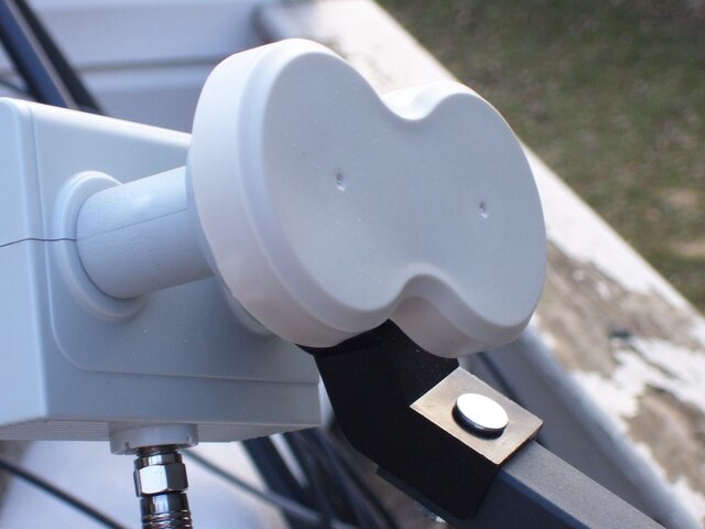

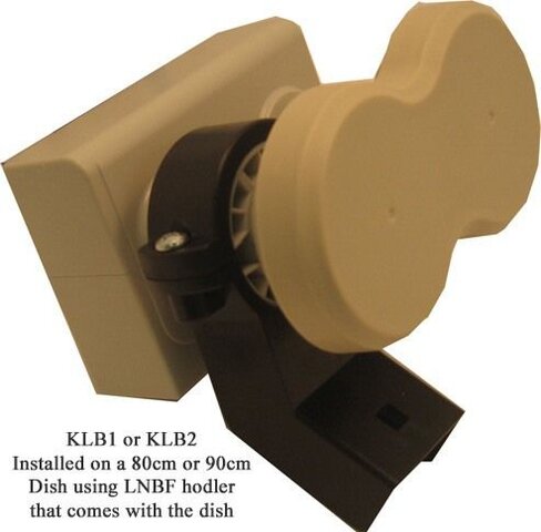

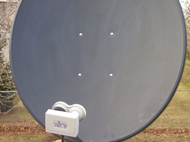

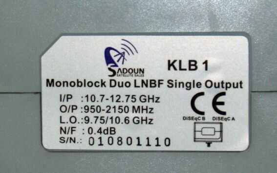

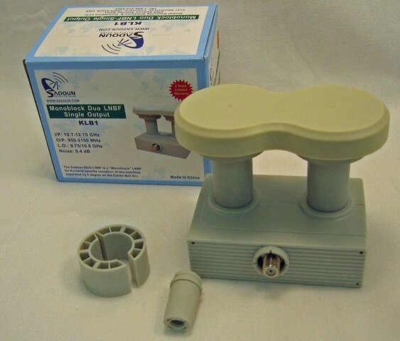

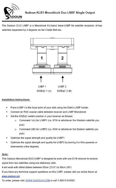

Since your dish is stationary and aimed at AMC4, there is a very simple solution for you to get G19 (97W) without moving your dish or adding a motor.
The solution is this:
You will be able to receive signal from two satellites at once with this Mono-block Duo LNBF.
Easy to install & setup. In your case, just clamp the left side LNBF on this unit. That will be your AMC4. Adjust the skew a couple of degrees. The right hand LNBF will receive G19. The unit has a built-in DiSEqC switch. Setup your receiver accordingly.
