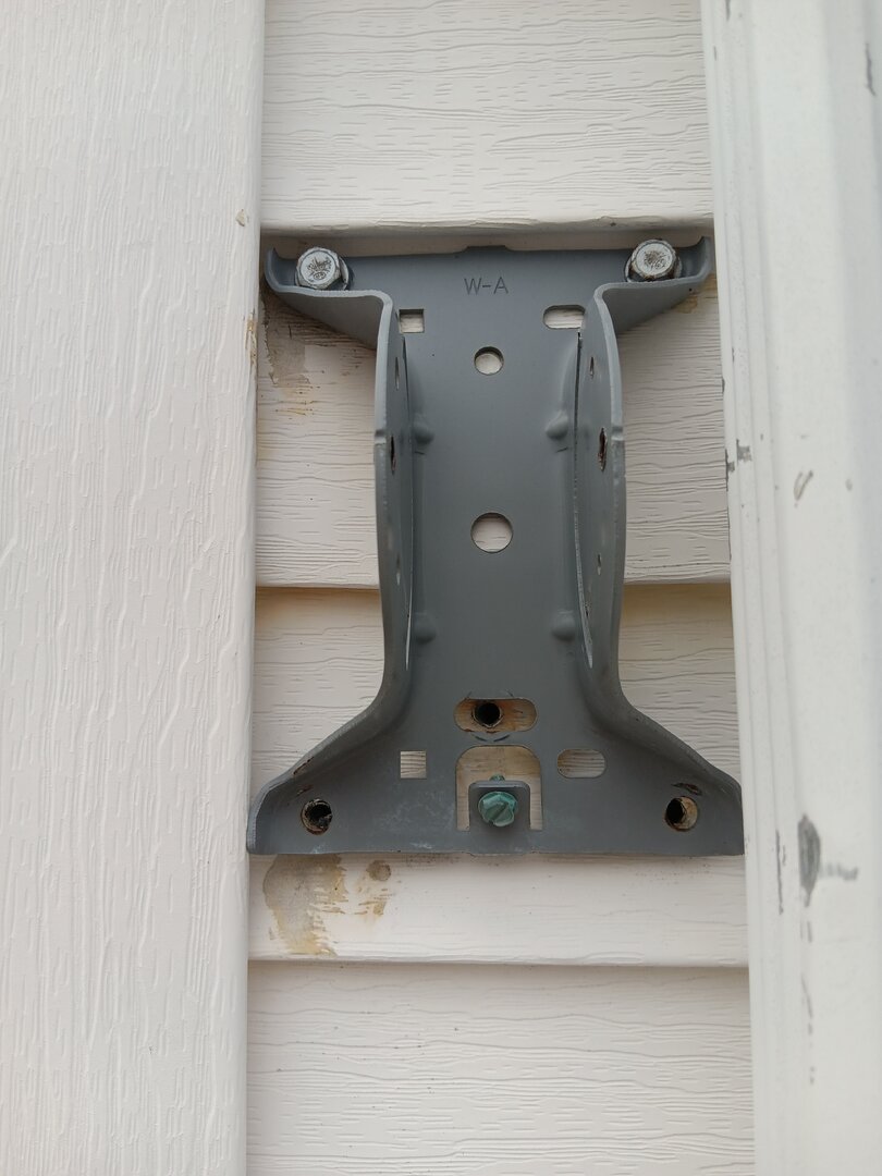

R RI_Lover New Member Original poster Jan 29, 2024 3 2 RI Jan 29, 2024 #1 How do I remove this part of the Dish I would like to know what wrench or tool I would need to remove this part please

dishdude SatelliteGuys God Supporting Founder Sep 7, 2003 28,634 55,453 Phoenix, AZ Jan 29, 2024 #3 7/16" socket. Reactions: MikeD-C05 and charlesrshell

tjboston5676 SatelliteGuys Pro Mar 8, 2023 889 1,893 Borger, TX Jan 29, 2024 #5 The mounting screws are actually 1/2" A wrench will work but a ratchet and socket will be much faster or even a drill if you have one. Then fill the holes with silicone or caulk. Reactions: MikeD-C05, TheKrell, That American Girl and 1 other person
