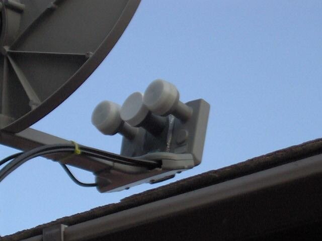

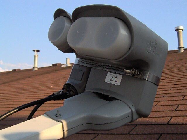

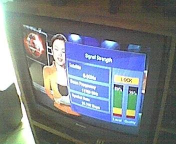

-Either a DirecTv Phase II or Phase III will work. Phase II has the removable LNB's and can be separated. I used a DMSI dual KU band LNB (looks like a DirecTV LNB) and put it right in the middle slot. Skewed like normal and voila....KUIL & 3ABN with a 22x20 dish (pictures below). A phase III you take out the LNB assembly and wedge the new LNB in there.
-A Dish 500. This is tricky as Dish uses "D" style LNB's and the DMSI ones are square
If you can find a 24" dish, that would work too. I've seen the older ExpressVu dishes (when they were KU) work just fine (SC dishes work too) :)

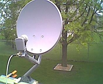

1st 2 pictures was a Phase II with LNB's at 91 (DBS for free audio before Evu scrambled it), AMC4 (middle) and Dish 110 (for subscription)

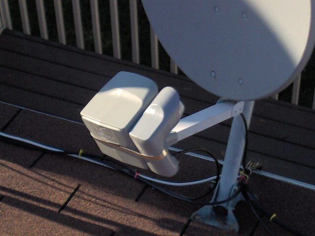

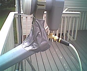

3rd & 4th was an old 18" I rigged up and got good results on G3

Both dont exist anymore...the 18" rig was just a test rig and the Phase II got taken down for a few reasons...mainly because ExpressVu scrambled the radio stations :(
Hey Iceberg, that is so cool. I didn't realize there's a type of LNB that would actually fit in the existing bracket for a DBS dish. Should make for a clean looking install (not that there's anything wrong with duct tape).

with 97 as TS 101 shuld be fine. I know with my Phase II I would get a 66-70 quality on the Fortec Classic

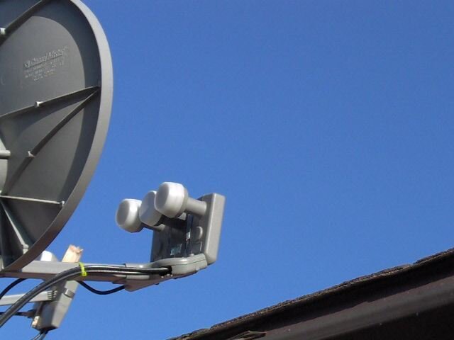

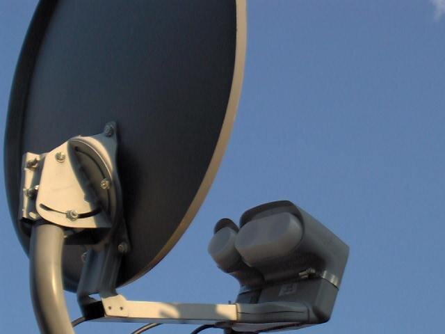

if you cant get 101 on the outside one, you could move it to middle, put the 110 LNB on the side and use zipties or a hoseclamp and put a LNB outside of the "w" adapter for 119
Here's what I mean. When 129 first was activated on Dish, I took a DBS LNB and just put it ot the side of the Dish500 I had and voila....129 :)

Putting the Ku off center would most likely not work. Even on a larger dish, Ku is very sensitive and requires optimal positioning. But it would be a worthwhile experiment :)

I have DN subscription and use a Dish 500 antenna with the same legacy quad LNB as shown in your photo, I also have 2 legacy dual twins sitting around, it looks like you used one legacy dual LNB mounted on the side with a hoseclamp to pick up 129* as stated.....if I did the same as you have, could I pull in White Springs TV on 129*? using my Legacy Dish 500 Echostar receiver model 3700. Or should I ask, what can I get from 129*?
And if so, with my Dish 500 pointed at 110/119, will the piggyback LNB see 129*? will I need to re-tune the dish at all? I'm very interested in this concept!!!

no it wont get White Springs. Tried it last night on the Phase II and barely a signal (10 on the meter)
yes the piggyback LNB will work :)
One more thing Iceberg, did you use any additional switches to link the piggyback 129* LNB? I do have a spare SW21 and do have a SW64 not in use.
If I use the SW64, can I just run the 129 LNB to it as the 3rd sat? And what are the values/signals of the 2 outputs on the piggyback LNB? In other words, does that additional LNB see only the 129* and transmit the same signal on both outputs?
depends on how many receivers you have. If you have more than 2 receivers, you can use the SW64 and all the recievers will see 110/119/129. Just redo a check switch.
If you have one or tow, just use a SW21 to combine the quad (110/119) with the dual (129). I only had one receiver so I just used a SW21 to combine them
