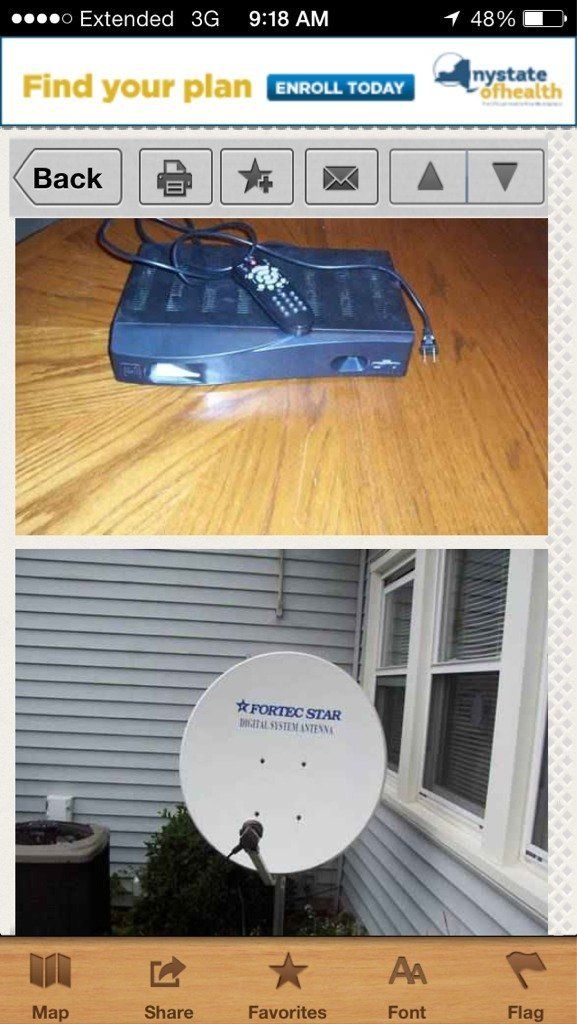

Is this a good setup for 97 west?
It's a fortec star dish and receiver ImageUploadedBySatelliteGuys1382966440.991482.jpg
Posted Via The SatelliteGuys Reader App!
I'm not sure what kind of receiver that is actually but it looks like it has a card inside I think it's fta any ideas?
If the dish is 31" or 33" it will work fine. That's what I am using here. The receiver is probably not S2 (HD) but should be OK for 97W since its mostly SD, 480i.
The guy told me that it's a dish network box and he used it with that dish and he used to get horse racing with it. Would it work on 97?
Can you get the make and model of the receiver? If its a DN box then it will not work for FTA.
If it was an FTA box modified to receiver DN then it may be able to get FTA.
That is an old DN box. That is no use to you.
Posted from my fingers via my Droid Razr

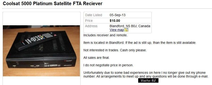

I recommend a new receiver. But if you're going to get an old one, at least tell us first the model you plan to buy. For example, I can drive over to a local today and pick up a very old Coolsat 5000 for $10.
I need a cheap receiver. Is the dish worth 25 dollars?
Yep. I paid $50 for a "setup" that had a broken motor, but the dish and lnbf were fine. It was a Fortec "80cm" (76 cm across, 81 or something up and down). $25 is a good bargain if the dish looks as good as it seems in the photo. Just verify the size as 31 inches or more. Certainly looks similar to the one I bought for my brother.
Not sure gonna pick it up tomorrow after work.
Re the LNB, in the pictures you posted, it almost looks like a linear FTA LNB on the end of the dish arm.
Funny you mentioned that the sellor used to watch horse racing. AMC 5 at 79W used to air horse racing channels. But AMC 5 is no longer active. Maybe thats what he used to watch?
