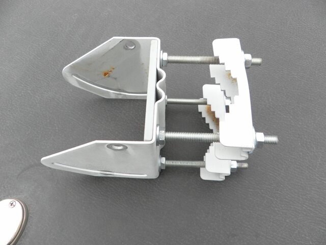

And another thing about SG2100 motors. The flimsy bracket design flexes when tightened which makes aligning the dish a nightmare.
I have had fun with that problem too.

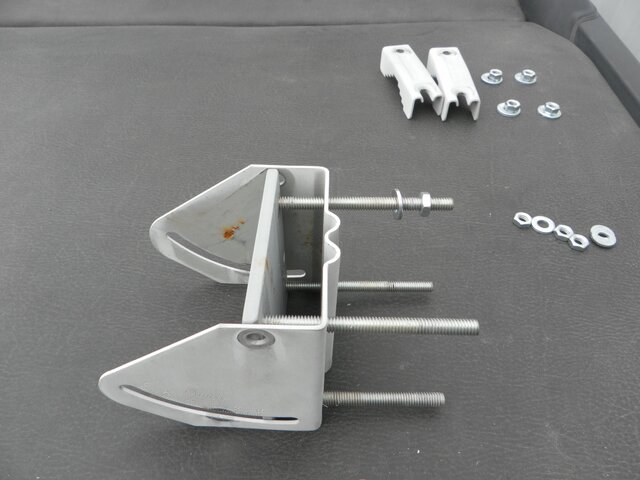

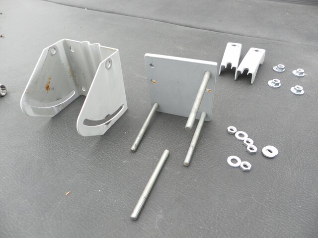

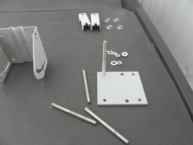

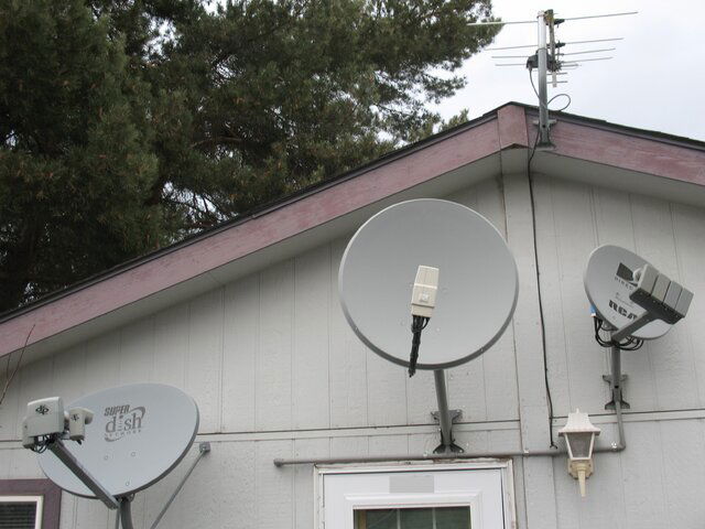

Magic, how did you resolve you flimsy bracket? Is that a current picture of your install. What kind of pipe did you use, and how did you keep it plumb?
Can you add more pictures how it is attached to your house. Thanks
I replaced the two U Bolts with the 1/4" steel plate and four studs to stiffen the bracket. I used 1-1/2" pipe to make the mast and used the foot and support arms from a SuperDish. I've moved the dish and replaced the SG2100 since those pictures.
