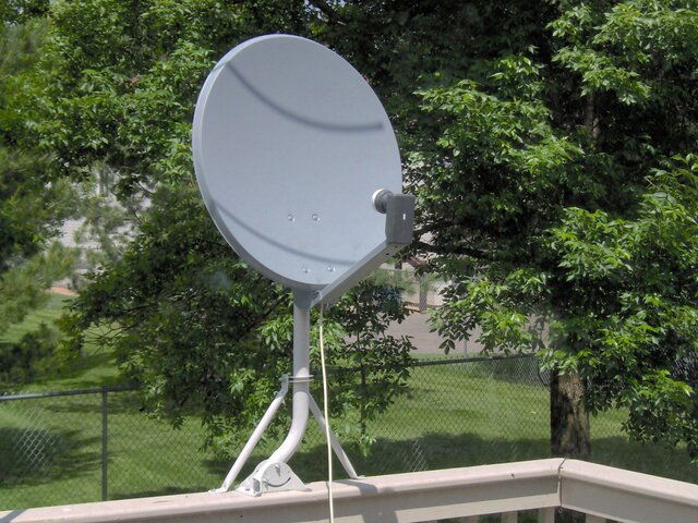

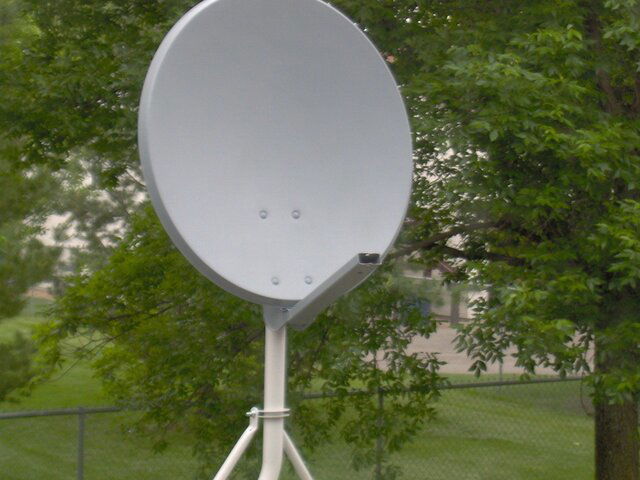

Since I had the mount already on the deck and was cleaning the "satellite room", I found my 24" dish. I figured "Well, we've tried a 30, a 36, a 18 and a 48...how bout a 24"?

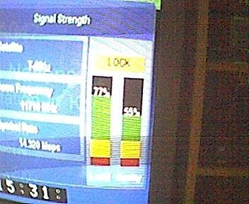

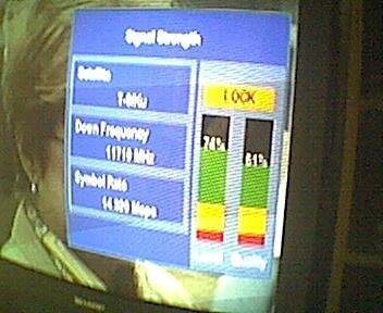

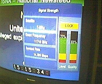

I hooked the 24 up and used the DMSI 0.5 I had (it slipped right into the bracket.) I had this dish when I had ExpressVu so it hasn't been used in a while. Aimed at IA6 (true south) and fired it up. Had some good signals and some not so good. Here is what I have between the 24" and the 30"
First number is the 24", second is the 30"
Bloomberg 56 73
Fox News Feed 32 59
Other feed 0 75
CBS News 60 60
CBS Feeds 30 45
ABCNewsNow 60 75
ABCSat 0 57
Other Feed 45 54
Lord/Taylor 60 75
Doc Scott 29 47
IRS Net 10 75
What was really weird is I used the Lord/Taylor as my test one and I has a 60 right away, but I also got a 60 on CCTV (G3) at the same time. No matter how far I moved east to tune in IA6, I could get G3 unil the end, when it disappeared. Most of the feeds came in fine, but it looks like a couple of them almost need a 30" to get a decent signal :)

Ive got better than 100' to my dish, but I can walk to it. It realy seams though to think of u guys getting up on the roof !!!!.............but I have to weed wack the weeds !!!!

its not too hard to get to my roof...put the 6 foot stepladder on the deck, climb up and there is the roof :)
(but I am starting to migrate some of the dishes to the deck railing for easy access :)
