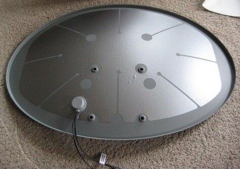

There are lots of de-icing gadgets on the market. For example: http://www.ebay.com/itm/Hot-Shot-Satellite-Dish-Heater-24-30-Dishes-Slimline-Exede-Hughesnet-Wildblue-/271101786294?pt=LH_DefaultDomain_0&hash=item3f1eecf8b6 Of course, depends what kind of dish should be de-iced.
I'm about to install one myself and the instructions say to place on the front of the dish. Does it really matter? Aesthetically it would look better on the back, but would it still be effective there?
Especially wet snow blocks the signal far easier than regular snow. On my WA that's what it takes, it has to be very heavy wet and stick well, otherwise I do not lose signal even with snow on it. EA however does lose signal sometimes even with regular snow.
If instructions say that than they are wrong. Such a heater, installed on the "face" of dish will block signal. All heaters have to be mounted on back side of dish; heating dish and melting snow.
That is how all the photos are shown with heaters on the dish. The heater does have a reflective material on it.
And yes, snow frequently blocks signal here. It is an EA dish located down wind of Lake Ontario. It is very common to wake up to a fresh foot of snow overnight. Sometimes the snow literally sticks to everything due to the static charge of the snow.
Could you show some picture with heater on surface of the dish. Just wondering.
I have 3 dishes with heaters, and all of them have them back-mounted. There are also rain/snow sensor, which suppose to turn on heat automatically when needed.
I've had the front-mounted dish heater for about three years... it works just fine on EA. The only problem that I have had, recently, is that the thermostat has failed to an "open" condition... no heat. I spoke to the tech guy at the supplier and he said I could hook up the power supply to the lead for the optional dish arm heater. That works fine but is in the "always on" state, not a big problem here with $0.055/ KWH electricity. I suspect the failure occurred due to the UV exposure, but that's just a guess. I would put the heater on the back if you can.
