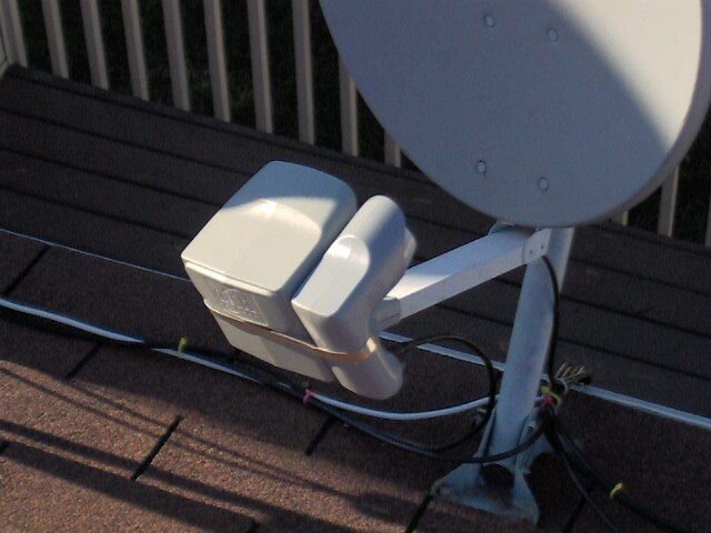

IN the below pic the one on the right (that is when I made my ghetto D1000 dish) has no switch in it. Do you have any of those around?

I have the dish twin legacy. the one on the left in the pic. some of the transponders that keep crapping out, the eb/no keeps changing ex 11.30 -11.20. I will try changing the lbn though.
Yeah but your twin legacy still has a built in switch. You need a legacy dual or single.
