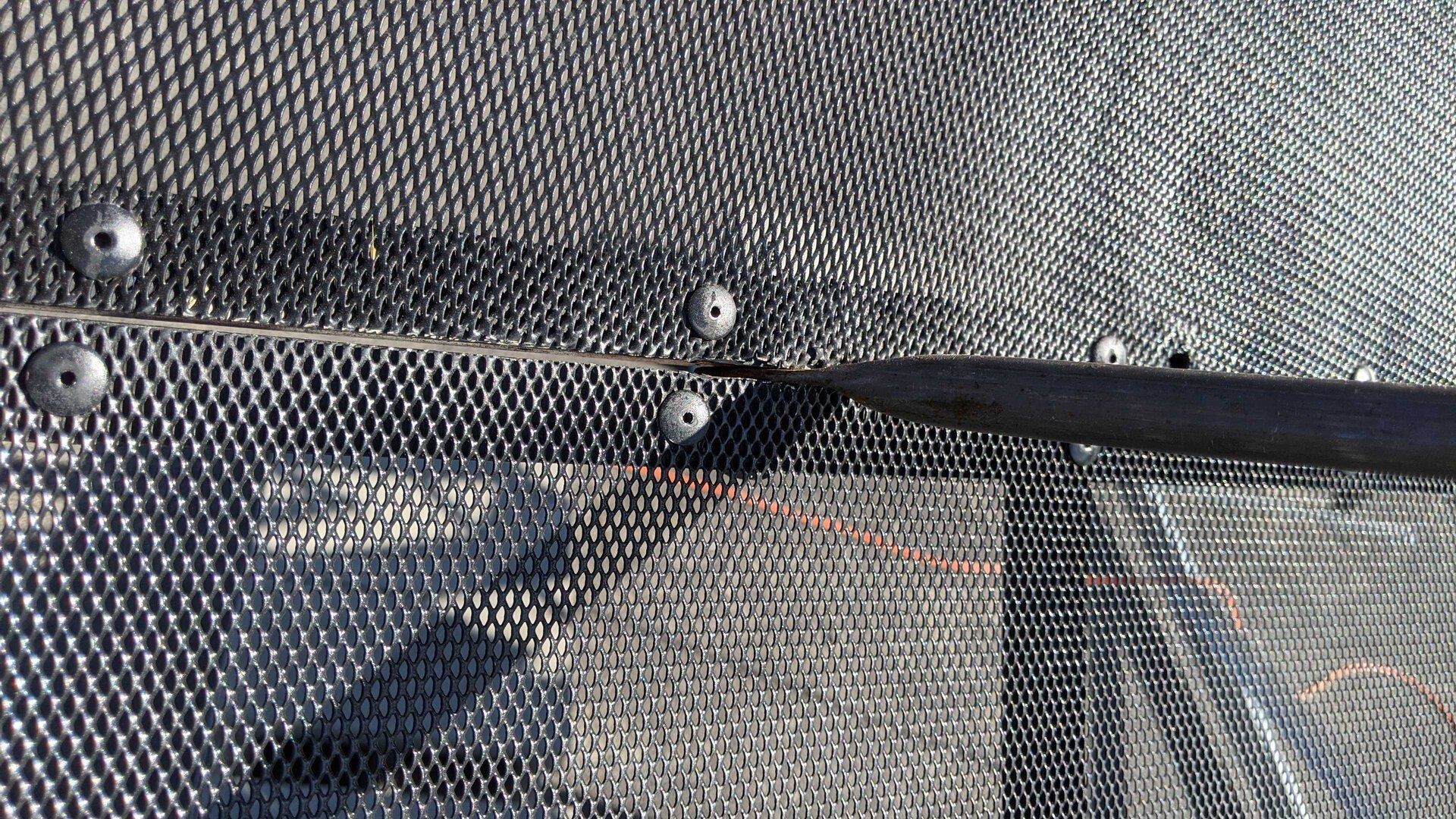

So i did some research and we bought a 12' and 14' TEK2000 mesh dish. After 10 weeks of waiting for all the parts to show up, and digging online for videos or anything other then the poor instructions that came with it that were literally "Make it look like this", and had images for a smaller dish, i was able to get it put together. I had to buy all new hardware for it as the small washers and tiny bolts did not seem adequate to me. I also took the scalar ring arms to a machine shop and had them make new ones with the proper orientation for the tabs. There were ATLEAST 27 random holes drilled in the mesh near where the rivets hold it down, and the parts were wet when they were packaged... Really not happy with these at all....

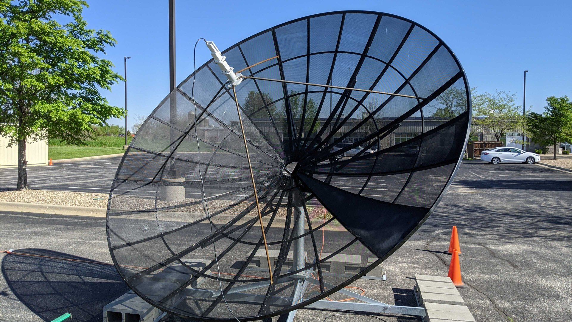

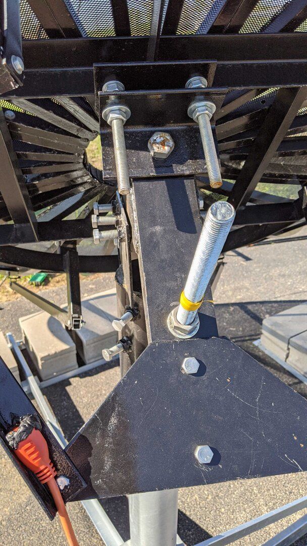

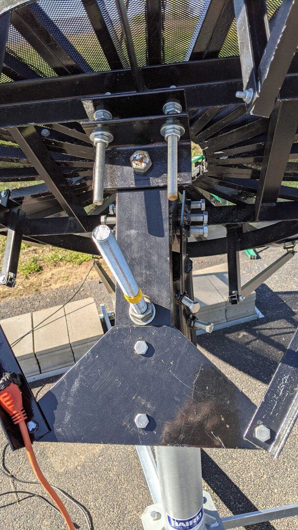

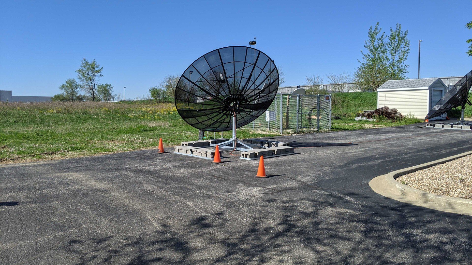

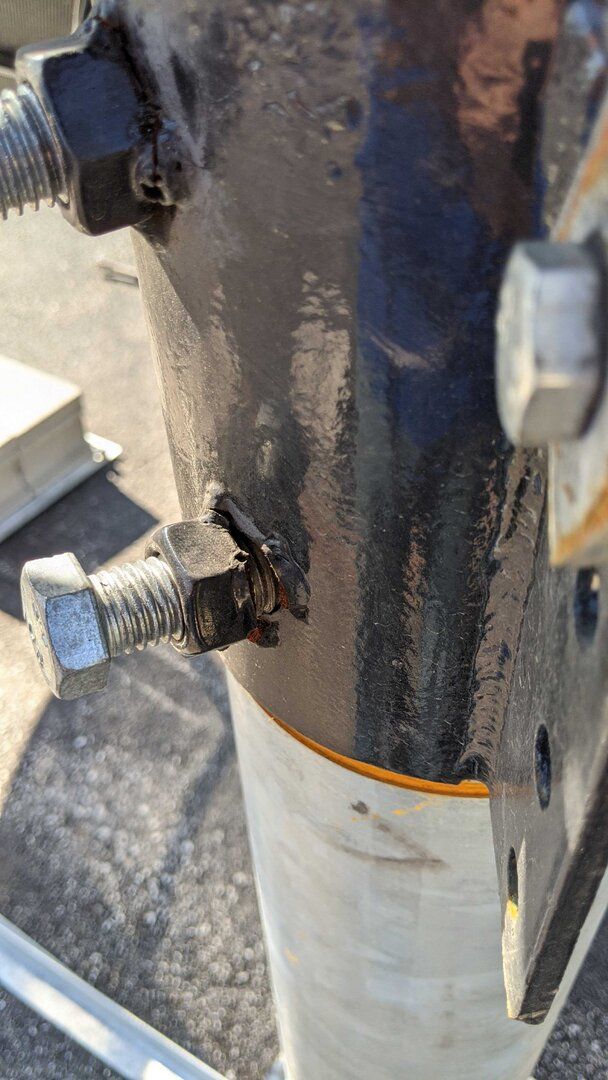

Here are some images of my dishes. I will add that i had to pull the lnb back out of the scalar ring pretty far to get what little signal i can
I'm no expert from the looks of your pictures i think your focal length is off. I has the tek2000 10ft dish and my LNB rods and to be screwed in 8.5 inches from the rim of the dish. I see you have 12 footer there. I am not sure where those holes should be.
Reactions: KE4EST
I measured 137 3/8" Diameter, 22 1/4" deep which comes up to 53.001 for a FL
I went out and measured from the scalar ring to the dish, and am at 47 3/4
I am a dumb ass...lol
It kinda makes sense now that i look at the holes that were drilled in the front of the dish, and how they sent out the scalar ring arms the way they were. I found the correct holes. I am going to drill out new ones in the correct spot so i can use the arms i got from the machine shop.

Whilst waiting for more ideas, i decided to go out, drill more holes, and get to my 53" focal length. Cut my hand on the pre-torn mesh, so grabbing a bandaide and going back out to sweep the sky
Set the lnb and dialed in TP 4120 as best i could. Get a nice lock on Galaxy 19 again. This time i get ALOT more channels and at a higher quality. I think i found my problem though. NBC national feeds are on 4120 97W, ABC nationals are on 4120 99W. That explains why i was getting channels from 2 birds. I found the sweet spot in the middle. I think i got it from here. I just gotta move the dish a little more west. my 6909 shows a poor lock at 4120 across a surprisingly wide area.
