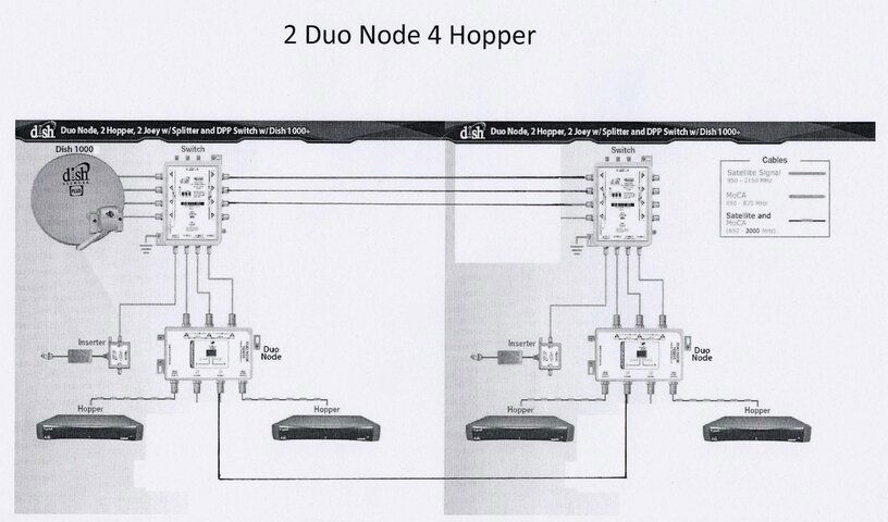

hello everybody,
here is a technical question for all installers
is it possible to connect 4 Hoppers and 8 Joey's to a single dish ? using 2 DPP44 switches with power inserter ? I know it works with 2 Hoppers and 4 Joey's on a single dish with the DPP44.
I know there can be only 2 Hoppers on an single account but this is not the question, I like to know about the technical issues.
Any input is highly appreciated !

I know about the 3 Hopper setup with a DPP44 and a DPP34 , I just think it should be possible to hock this up like a 2 Hopper setup on a DPP44 just with the second DPP44 connected on the output from the first and then do the same like the first 2 Hoppers. This is only a theory so far.

4 Hopper setups work well and can have access the recordings on any Hopper in the setup.
Thank you Kevin,
do I have to hock them up like I thought or is the setup somehow different ? Do you have a wiring diagram or do you know where to get one ?
Thanks a lot :D
M.
Like you thought and then just connect a short cable between client ports on the two duo nodes.
Here's an image I made back before the Hoppers were even released.
Thank you Kevin,
I understand the setup but how am I going to connect the 8 Joeys to the Hoppers, 2 each ? It won't matter if they can't access the recording from the other Hopper

Back to my original question, I just connect the second set of the 2 Hoppers and 4 Joey on the pass through with an additional DPP44 with power inserter and do the same setup as on the first switch ? Should work, just there wouldn't be any access to the recorder from the first 2 Hoppers since there is no possibility to connect the data - right ?

Yes you can have four hoppers. My warehouse has 6 on one dish and they all see each other. Your going to have to pay for hoppers 3 and 4 and in most cases 2 as well.
1000.2 EA(or WA depending on the market) to a your DPP44s and then to your duo nodes. On your nodes run client straight into client and they will all see each other.
Sent From My Samsung Hercules
The cheapest way is one DPP44 and one DPP33 on the DPP44's passthrough ports. 1st port on the DPP44 takes the power inserter, then the remaining three go to a duo node, and the 3 on the DPP33 go to the second duo node. Connect client ports together and voila. Everybody sees each other. ;)

OK, Here is how it works
A DPP44 with power on port one connected pass through with a DPP34 or DPP44 with power, then each of them to a Duo Node, on each Host port one Hopper, on one client port on each Duo a 4-way splitter to 4 Joeys, then the second client port interconnected between both Duo Node's.
My problem here was that I didn't realize that I can split the client connection to 4 Joeys ! Now it's clear and the problem is solved !
