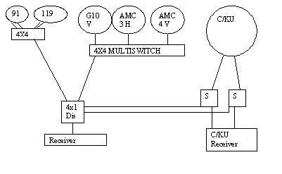

OK...here is how I would set it up (just my opinion)
4x4 multiswitch gets all 4 lines from the 2 18" dishes and run each output to a 4 way diseqc
if you have a 3x4 switch ( ;) ), hook G10 to 13v and amc3 to 18v. Run each output to port 2 of 4 way diseqc
the other 2 ports can be the 6 footer (since the polorotor will be stuck at V it will only work on that and port 4 can be a feed from the big C-bander
that won't work right...forgot to take into consideration the KU port on your C-Band setup
on another 4x4 switch, hook G10 to 13v and amc3 to 18v. Hook up the 6 foot C-Band to the 13v+22k side. The 18+22k can be used for something later on...Run each output to port 2 of 4 way diseqc
the other 2 ports can be for the C & Ku ouputs on your big C-Band setup

That looks pretty interesting and might just be the ticket. If i eliminate one of my 18" dishes then that would allow me to go ahead and put a second feedhorn on the 6' dish and try to get two sats with one c band dish
Tony,
I cant open the attachment on this computer, but I think I can visualize the layout, and it should work.
Once again, thanks for all the help,
Doc
here is a pic
That looks perfect Iceberg, "you da man". Once again, thanks for taking all this time to help me work this out. So if i am looking at this right, all I need is 4 disecq switchs and 2 4X4 switches. Awesome :-D
