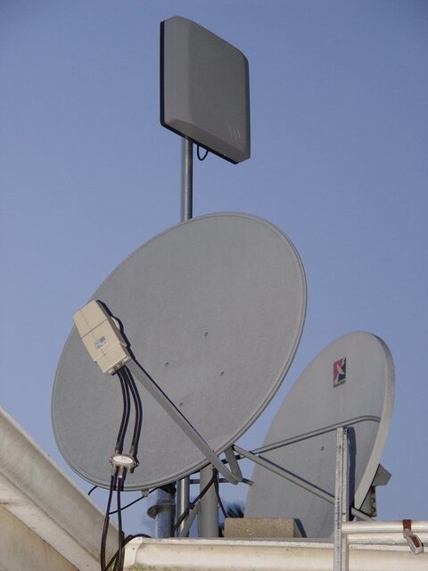

Janzy, are you referring to the Invacom QPH-031 quad? If so, it depends on if there are any obstructions on your roof close to the dish. As far as the QPH LNBF actually hitting the flat roof, that should not be a problem. I'm using NPRMs in my dish farm, and one of them (soon to be two of them) is motorized... a 90cm Azure Shine dish on an SG-2100 with an Invacom QPH. The slanted portion of my roof is even next to the dish, and I have never had the LNBF hit.
