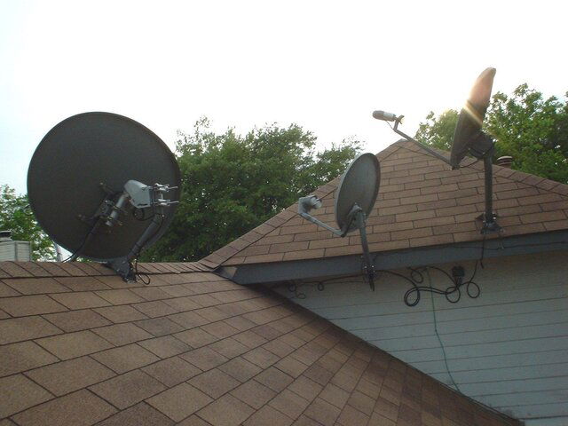

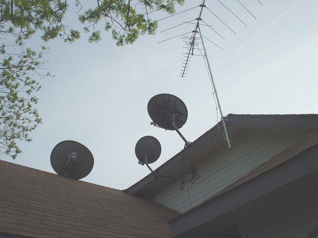

Just wanted to post my experience this weekend. The system consists of a
Patriot 85-E dish, Extreme II lnb,
Motek SG2100 motor and Traxis DBS3500.
I decided to mount it on the roof directly through the shingles to the
rafter. The mount that shipped with the dish would not work for this so
I sourced a used mount locally and used it. It is not as large as the
other so I will look to replace it soon. The only thing that gave me any
amount of confusion/ problem was the single lnb bracket that came with
the dish. I could not get it to work with the extreme II lnb. It just
did not fit correctly no matter how I rotated it. I actually spent more
time with this part than aiming the dish. I just used the multi lnb
bracket that also came with the dish and positioned it at zero.
Another small bit of confusion was with setting the polarity of the LNB.
From reading the info on the DMS website it appears to just make sure
the mark on the LNB points up. This is what I did and it seems to work
fine.
I have a small amount of experience aiming dbs dishes and one fixed KU
dish but this was my first attempt at a motorized unit. I decided to
give a go at installing with the motor rather than first trying without.
I had no problems at all and managed to find IA5 (true south) on my
first try. I was able to track the arc and receive everything from IA-6
/ 93W to IA-7 / 129w with no problems using the USALS in the antenna
setup. (there is a tree blocking the view any further to the east, thats
a future project) I am still a slight bit off, however as some off the
weaker transponders had/have low quality om G10 even after I improved it
with a small amount of tweaking. I have temporarily compensated by using
DiSEqC1.2 on G10 and storing the position after moving/ bumping two
clicks to the east. Does a single press of the button equal a full
degree movement of the motor?I now get everything on G10 with DiSEqC1.2
and all the other sats/ active TP's in my view by sticking with USALS.

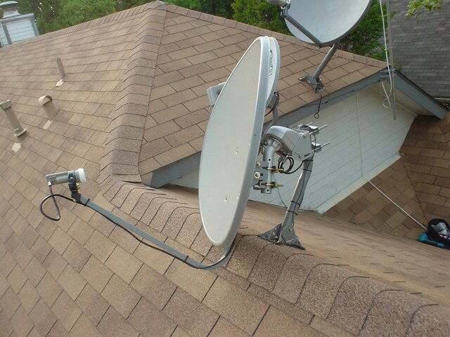

From your pics, it seems like the dish is very close to hitting the apex of the roof. Have you tried to move it to both sides of the arc to make sure it doesn't hit the roof?
The dish does get close at the far east and west but it does not hit the roof. The main reason it is this close is that the mount I am using is a bit short. I plan on replacing it soon with a heaver gauge/ taller mount. The dish is pointing to my far west sat @ 129w in the picture above. The angle I took the picture at makes it look worse than it is as there is about 3 inches of clearance left.
