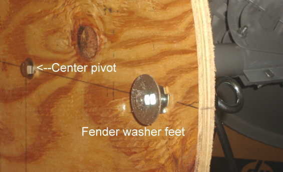

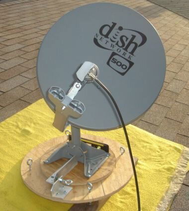

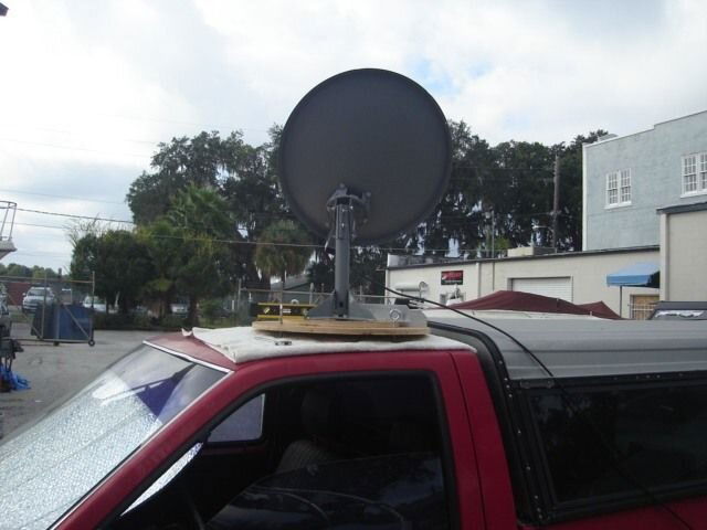

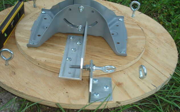

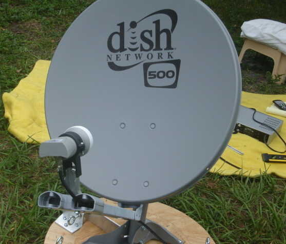

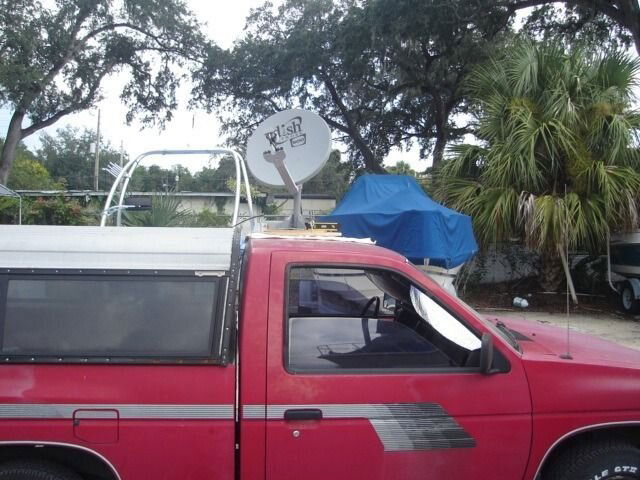

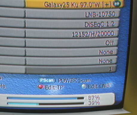

Hi all, I was in the mood to make something and got inspired by the
interesting project Mikelib did a while back using a Dish 500 and a
neat mount. I decided to make one myself with my own twist, a micro

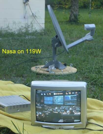

adjustable azimuth. One of my goals was to be able to watch NASA on
119W so I needed the original LNB. Went shopping on Craigslist and
found one nearby and got it cheap. I plan to use the NASA setup to
go watch a live shuttle launch from the Cape. Setting it up for
portable operations from the tailgate.
I was also hoping to be able to get some of the stronger
transponders on some of the linear satellites. Russia Today and Al
Jazeera English would be really neat to be able to get on a small
portable (camping) FTA setup.

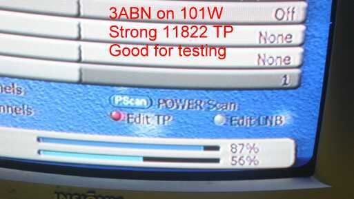

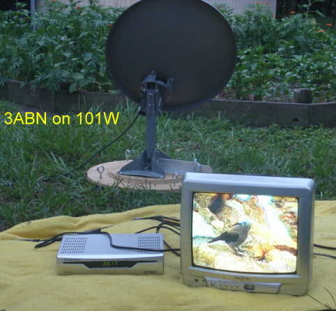

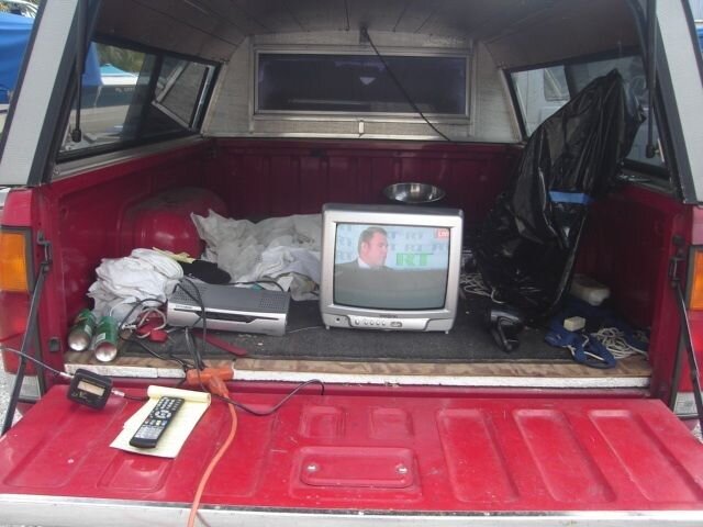

The weather this morning when I wanted to test the setup was not
good with a think overcast so I started with the very strong 3ABN TP
on 101W to see if the thing would work at all and to try and fine

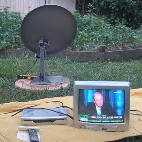

tune the rig. Well, I found 3ABN and was surprised and how strong it
was. Things were looking good so I moved over to 97W and was able to
get a lock on RT. That was so cool! The threshold for picture
breakup on my Mercury II is 28% quality and I was able to peak the
little dish for 35 to 40% on RT so it is solid. The micro
adjustments make it a snap to get the last little bit out of the
tiny dish. It turned out to be a fun project. Check out the
pictures.
BTW - if you want to check out Mikelib's post search for "Dish 500 Hispasat"

Interesting advancement with that micro azimuth adjust! - :up
I'm all for threaded rods or big screws to make finding birds easier.
So, you mount the circular in one half of the Y, but turn the Y upside down to use the linear LNB 'n mount?

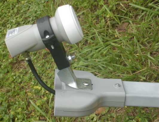

Thats a neat project! Where'd you get the lnb bracket for the linear lnbf?
Did you try it out on Pentagon channel yet?
I thought I recognized that bracket.
Looked all over Sadoun, SatelliteAV, and the WSIdigital web sites, and didn't find anything close.
But, DMSI sells one, and here it is at one of their dealers.
Looks nice.
Of course, over the years, many of the members have come up with imaginative brackets too! ;)

I purchased one from megasat for around $8.

Hi Anole, regarding the Y - I do not flip it over, it stays put. The original LNB uses just one little screw to pin it in place. All I do is remove the screw and pull the LNB out. Then the linear mount can be installed. I thought about setting the linear mount off set to the side of the original LNB but the Y is not flat in the spot the linear LNB would need to go and I thought I might gain a couple of points by putting the linear LNB in the center. So in the end I decided to keep it simple. I also wanted to keep the project as cheap as I could. The plywood and aluminum bracket came from scraps. The LNB is a DMS International (PN JSC321S) and the bracket came from hypermegasat. Both the LNB and bracket delivered to my front door for under $20. The whole setup needs to be cheap enough that I don't feel guilty about parking it in storage. If I put any expensive parts on it I would want to raid the dish and use the parts on another dish.
Regarding the list of channels that can be received by small Ku dishes - I think that is a great idea. Something that I have noticed when I compare the reception of the little dish to my 80 CM is I loose about 20 points on the signal quailty. So I need a TP that is showing a steady 55% Q on the 80 to have a chance of getting it on the little dish.
Take care, DC

Hi turbosat, the LNB and bracket came from hypermegasat. See my other reply to Anole for the PN.
I just motored my 80CM over to 103W and have the Pentagon channel on now. I checked the signal quality and see it is not very strong for me near Orlando Florida. I'm only getting about 40% Q on that TP so it does not look like that is a channel that will work on the little dish :(
The next satellite I want to try is 72W. The NBC MUX on that bird is strong. I'm seeing over 60 % Q with my 80CM so I think I can get it provided I can find LOS to it. I'm a tree hugger and have about 12 trees in a small city lot. The trees will NOT see a chain saw! Finding a slot will be a bit of a challenge but I think I may have a spot.
Take care, DC

Update - The Pentagon ch is doable on Dish 500
Hi all, just wanted to post an update. This morning I played around with the skew on the small dish and was able to get a lock on the Pentagon channel. I had a signal quality around 35% and that does not give much over picture breakup but it worked!
Ended up with the skew at zero like it would be for my due south sat.
After I was done with 103w and the Pentagon channel I moved the little dish over to 97w and peaked it for Russia Today which is on a horizontal TP. Then I tried to get Daystar that is on a vertical TP but the signal Q was below breakup. When I switched back to my 80CM dish I noticed Daystar is stronger then Russia Today. Not sure what to make of that. Why would there be a difference between V and H signal quality.
I think next time I have the small dish out I will try to peak it on the vertical TP for Daystar and see how it does.
Later, DC

this is interesting. Does anyone think it would be possible to get the 97w satellite on one of these things?
I found bunches of them in the tool shed, my X collected them like bottle tops or something. Maybe he had a fetish for the little dishes. LOL!! :p
I think I could manage to make one. Can you mount it on a pole like other dishes or is all that complicated wood stuff on the bottom required?
I am pretty sure I can do it if all you do is bolt a new lnb on the little dish and put it on a pole like other dishes. But I'm not about to attempt all that crazy wood stuff like in the example. :eek:
Thanks! :)
Hi Dee_Ann, Yes some channels on 97w can be had with the little dish. Russia Today and Al Jazeera English are on TP 12150 on 97w and I can get them on the little dish. There is not a lot of margin on the signal quality so it would not take much weather to cause picture breakup but it does work at least when there is no rain around.
Yes the Dish 500 uses a standard mast size (1 5/8) and could be mounted on a poll. You will need to peak every last little bit out of the dish and my custom mount helps with the peaking but I'm sure I could get it to work on a poll too.

Let me know if you need the measurement for the mounting of the LNB bracket. That is really the only tricky part and must be right on the mark.

Took it for a test dirve, very easy and quick setup.
Hi all, I took the little dish for a test drive this morning. I parked the truck and set it up on the roof. The leveling eye bolts made real quick work out of finding 97W. I simply level the base board then loosen the bolts on the dish clamp for a quick azimuth move then as soon as I get a signal I can fine tune with the eye bolts.
Here are some pictures of the tailgate setup.
Later, DC
