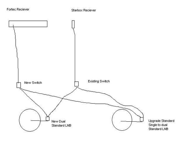

I ordered the S1 sytem from Sadoun with a 90u upgrade. I already have my eye on another satellite to point at:eek: . Anyways If I am understanding things right I will need to change the lnb on my current dish to a dual then add a second swith to the fortec reciever? Now would I need to turn lnb power off to either the fortec or my usb tuner?
I will draw a little diagram of what I am planning for wiring for you to check out later tonight and any input would help.

Welcome to the club!
If you don't need different polarities on the same bird I'd just slave the DVB card to the Fortec. If you need different polarities then both devices will need to power each side of the LNB.
no need to turn the LNB power off. Both will work just fine independently (if you hook each receiver to the LNB)
The attached Image is what I am planning on for my connection when I recieve my reciever and new dish from Sadoun.

Thanks for the input. Now let me throw in another loop....getting about 15 steps ahead of where I am now.... Lets say in the future I wanted to add a motor, actually two because of my los.
I would need to put my dishes in two locations one views 90 deg to 61.5 or more. The other views 90deg to 148 deg or more. Is it possable to tie both dishes with motors with switches? I picked the degrees from lyngsat for north america there may be further sats but I have no idea yet.
This has to do with placing my second dish for future expansion.
You would have to keep the motors completely separate or they will conflict with each other. Each motor will require an independent receiver to remember the satellite locations.
