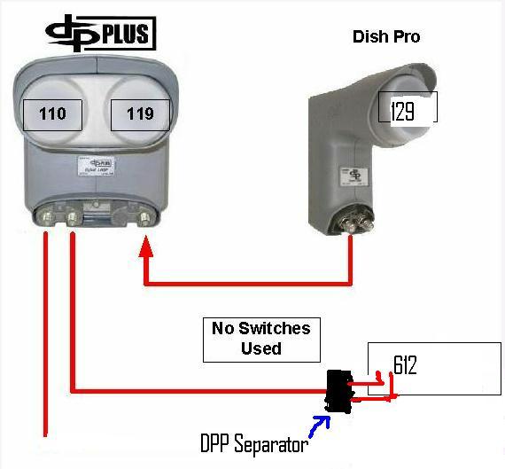

You don't need a DP34.
Connect the single LNB (most likely a DP Dual that picks up 129) to the "input" on the DPP twin.
Run one line from the DPP twin to the 612, and use a DPP Separator.
Here's a wiring diagram. Ignore the receivers that they are connected to (and the "148" listed on the single LNB), and remember to use a Separator on the 612

Where does that pretty red line from 110 go to?

Hey Matt, I just tried hooking it up just as shown in picTure... I'm getting no signal help?
Ok azimuth 232 elevation 33 skew 124 I have ll this done the mast is level I have the point dish on the dvr and I'm getting absolute no signal am I using this wrong?
