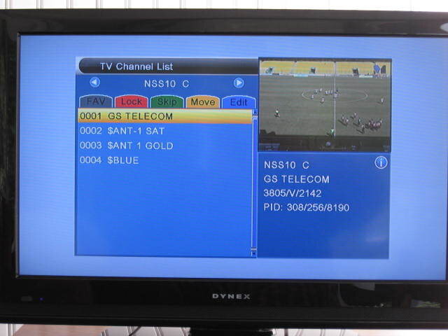

I think i found NSS 10 C 37.5w! What do you think?The selected Tp is metro tv from Ghana.
