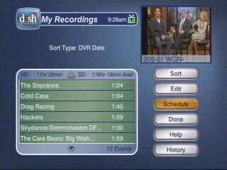

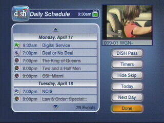

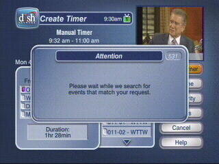

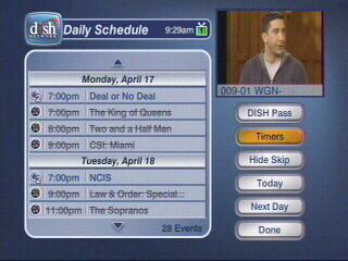

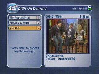

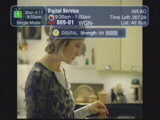

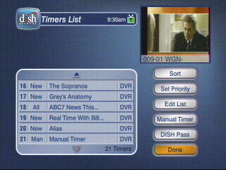

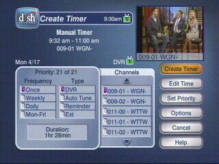

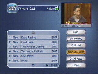

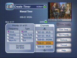

1. Press DVR on your remote
2. Press DVR again on your remote.
3. Highlight Schedule on your screen and press the SELECT button on your remote.
4. Highlight Timers on your screen and press the SELECT button on your remote.
5. Highlight Manual Timer on your screen and press the SELECT button on your remote.

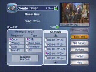

6. IN the LEFT box under FREQUENCY use your remote to cursor under how often you want the timer to fire.
7. IN the Center BOX use your remote to cursor to the TYPE box and select DVR or EXT (if external Hard Drive is used. NOTE: THE EXT FEATURE IS NOT ACTIVE AT THE TIME OF POSTING! )
8. IN the Right box Use your remote to cursor to the Channels box and select the proper channel. (NOTE: I used WGN 9-01 which dish does not carry over the EPG GUIDE DATA from its SD version to the OTA HD version IN CHICAGO)

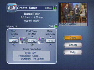

9. Use your remote to scroll over and select edit time and press the SELECT button on your remote control.
10. Use your remote to cursor to the times you want the timer to fire and use the key pad on the remote control to set the time. For 930 you would select 9 3 0 on your remote. for 1130 you would select 1 1 3 0 on your remote. Then use your remote to cursor to am or pm and select when you want your timer fire in the am slot or pm slot. Do the same for the end time.
11. Use your remote to cursor to done and press SELECT On your remote control.
12. Highlight the create timer button with your remote control and press SELECT on your remote control.
13. An attention box will appear for 2-3 seconds

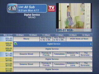

14. Verify the timer is in the timers list and select done.
15. You should now see the timer in the daily schedule box and select done.
16. Press VIEW LIVE TV button to quickly exit out of all the menus.

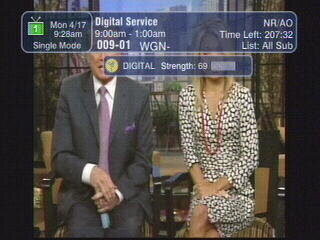

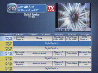

17. In your guide when you scroll over that channel you set the timer on and will not see a timer in the guide.
18. Scroll to the time you set the timer up for the channel and the timer icon appears.
19. When the time comes for the timer to fire the timer fires.

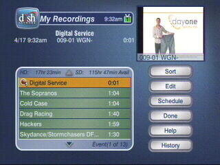

20. The recording shows up as DIGITAL SERVICE in the my recordings option (dvr button twice) for later viewing.

I will hijack this thread to once again crab about Dish's decision to mark OTA with no guide data as "NR/AO". Those of us that have locked out the more risque programming because we have kids are forced to enter the lock code to access any OTA program. If they used "NR" instead, it wouldn't trigger the ratings lock.
Yes, let's fire off something to ceo@echostar.com
It is annoying as hell to have to come in and enter the lock code all the time
because of the way they have done the ratings filter. I have 3 kids, so it gets old real fast.
