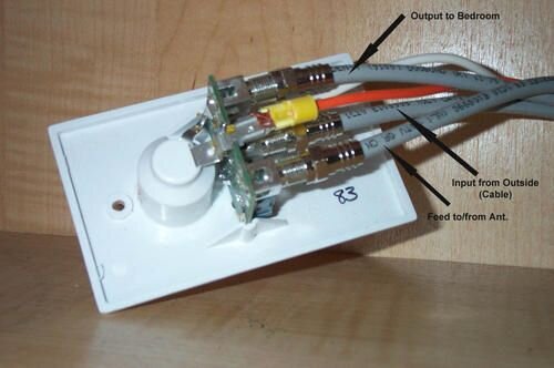

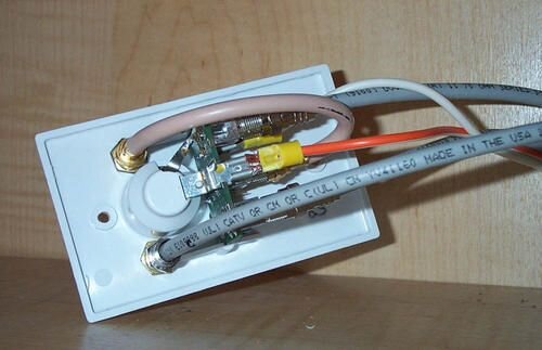

I modded our Amp. Faceplate to take the outside cable directly to the faceplate but also had a second jack to loop the cable back into the faceplate input in case we had regular cable connection.
It also allowed us to take the RF output from the Receiver and feed it to the other TV jack in the back.
Also, as noticed in the pic, most trailers/RVs only run RG59. I don't expect the short run from the exterior wall jack to the Receiver (<6 feet) will cause much attenuation.

Just wanted to make sure that I understood your above modification to the Winegard faceplate correctly. By running the little jumper/loop cable to a new jack, this will allow me to view cable tv when available, satellite tv if I want to, and still use the antenna (not all at the same time of course) without any other modification? I would simply hook the tv into the looped cable jack if wanting over the air tv or cable, and hook a sat. receiver to the other new jack if using satellite? If that's the case, this is what I will do. Seems to be a simple solution.
By the way, I have Direct Tv. Don't know if this makes a difference.
Karen
DISH_NC
Karen
Correct, using a small loop of cable between the left and right jack, you 'jumper' the outside "Cable" feed into the existing faceplate as if the mod was never done.
DirecTV/DISH - no difference with respect to this mod.
