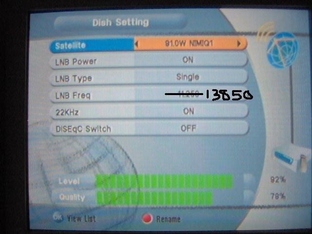

OK....couple ways to do it
easiest way is this....in your dish settings where it says "LNB Freq" its right now 10750..change to 13850 (as shown in pic below).
Save it
Then do a blind scan but only scan V side

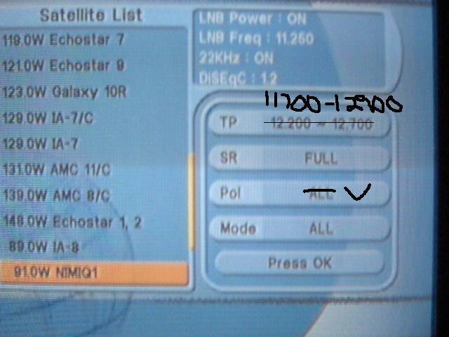

second way is to leave the LNB frequency as is but in the blind scan change the info to such
select the TP range and change it to 11700 to 12900 and hit OK
scroll down to "pol" and select "v"
hit OK
should allow it to pop in

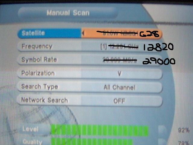

3rd option is manual scan
menu
installation
manual scan
enter the info EXACTLY as shown in pic below (I think its green button to add a transponder..I forget..not near box right now)...when you enter the info the bars should turn green
hit OK and it will scan it in
Thanks Iceberg, doing this with the manual scan reveals that my signal quality it is in the red (5-7%). I will adjust my dish and then try again. May be a few days from now. Going back on the road till saturday or sunday. thanks Jason
