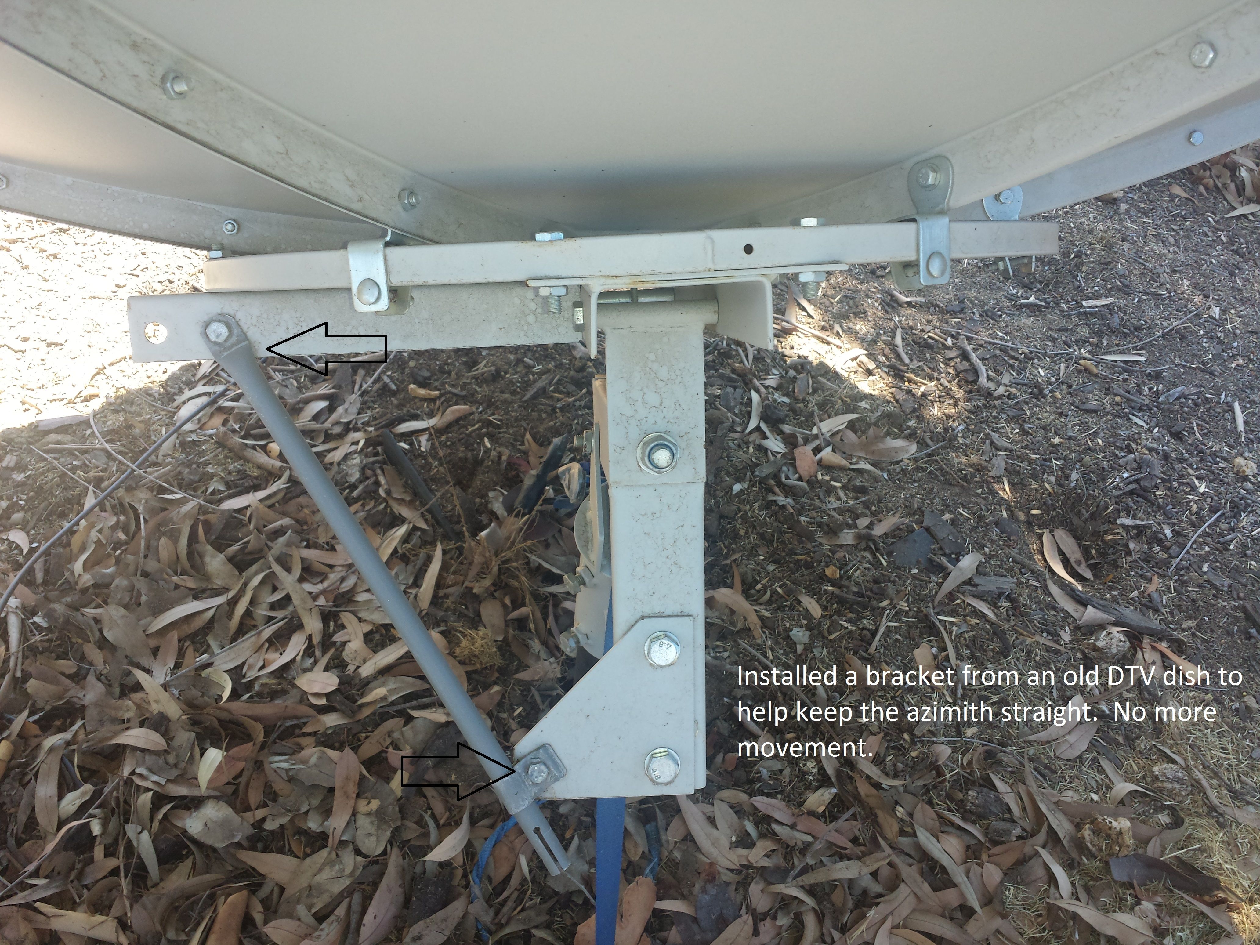

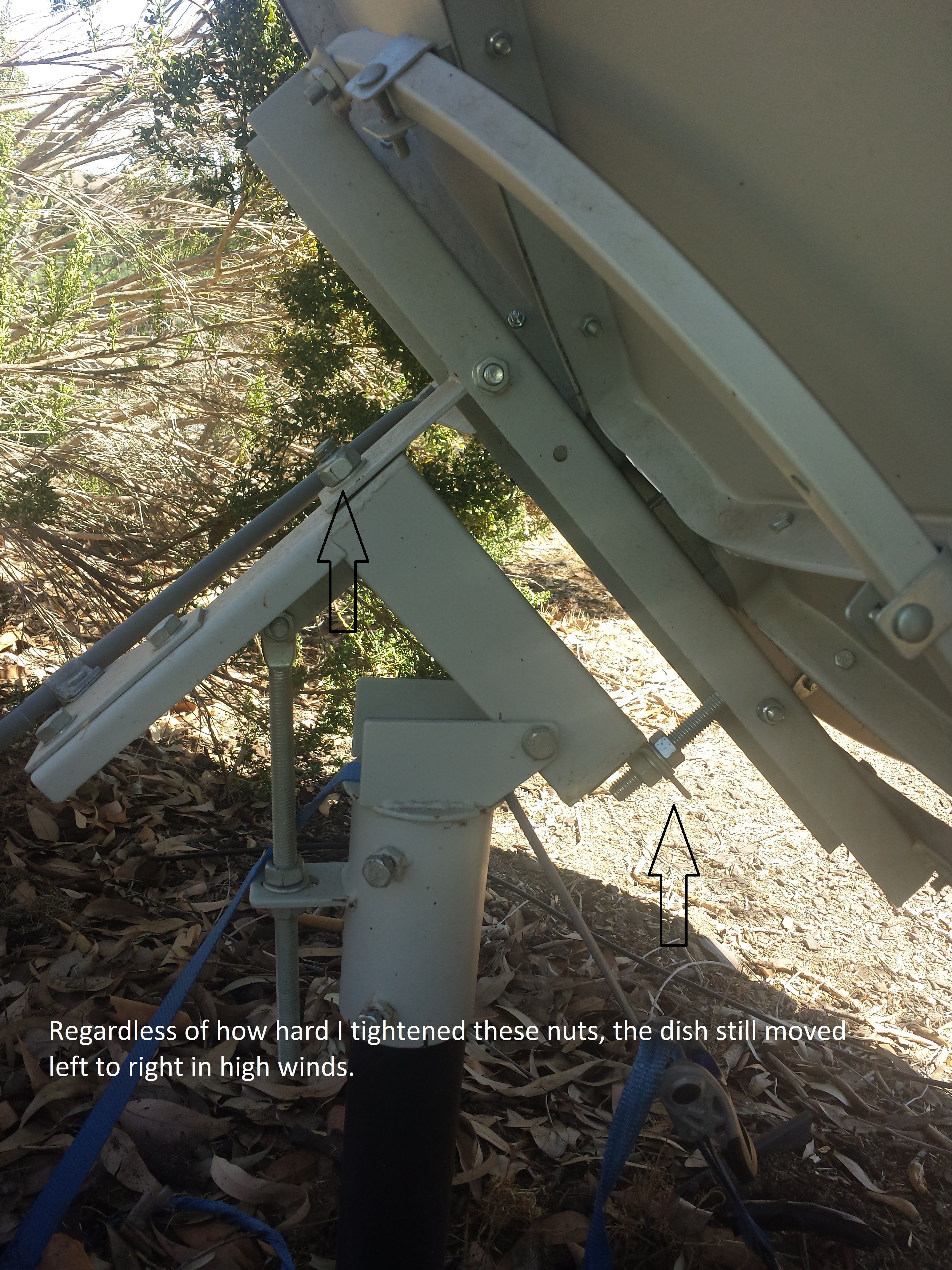

In addition to the great advice already offered. I would ask if after your mount bolts are tight is there any left to right movement in the dish? I only ask because I had that problem with the Sadoun 6 ft dish. Regardless of how tight the nuts were in Image 1, the dish would still move pretty easily from left to right. I fixed the problem by adding a bracket seen in image 2.

Oki,that sure looks like a Polar mount to me.Where you put that brace is where the actuator is supposed to go to move the dish.The bolts you were tightening aren't meant to lock down the dish.
Reactions: OkiMarine
I understand Waylew and have learned a lot since starting this hobby. I didn't have an actuator for this dish and only wanted it aimed at 99w. I just seen that Vallenato's dish looked almost identical to my Sadoun 6 ft dish minus a couple brackets that could have been left off.
Nothing wrong with using just the brace (and as you found out,it's what you needed to do) when you only want to point at one sat.Just pointing out that what you were originally trying to do (tightening the bolts) wasn't going to work,it's supposed to move there :biggrin.
My 8 ft mesh came with a polar mount so you can motorize and also included a lockdown bar (like OkiMarine is using) that goes where the actuator would normally mount in case you just want to use it as a stationary dish. Kinda nice having the option to do either if you choose.:)
