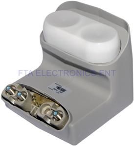

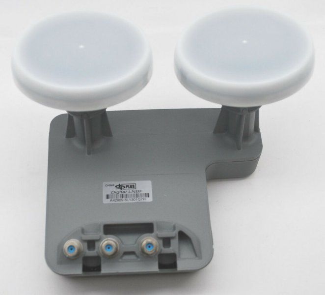

Which LNB does he have? The first one is the SD for 110, 119. The second one is the eastern arc HD for 61 and 72 Sats
It looks more like the second one but I'm not 100% sure. If I sent you pictures (later) of his dish and LNB could you tell me more about it?
So can he get HD off of satellites 61 & 72?
Which way is the best setup? I never thought he was possibly using different satellites altogether.
I'll do some more investigating and it might answer my questions. Like which way his dish is pointing and what kind of LNB'S he has. I want to say THANK YOU FOR YOUR SUPPORT!
St. Louis has locals on both arcs, so yes, he can get all the same channels in HD as you do.
