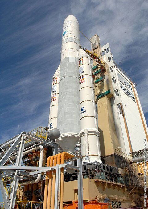

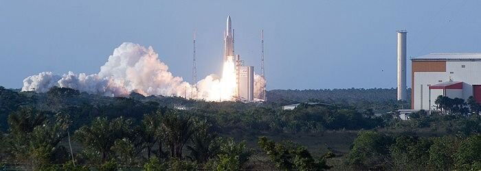

AMC 21 is supposed to be launched tomorrow August 14th. The launch window opens at 4:44 pm EDT. If all goes well, commercial service should begin in about 6 weeks. PBS should be on both AMC 21 and AMC 3 for at least 60 days after that.
Arianespace
125º West

Yeee haw! Ride 'em cowboy!
Wonder how long 'till it's in position and checked out ?
edit:
Will be nice to see it on line.
