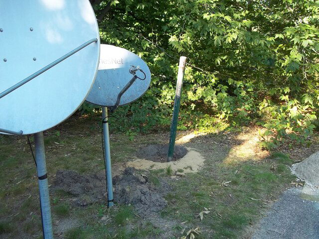

Ran the coax to the post today. Sure happy I put that plastic pipe in the driveway before I had it paved several years ago.
Picture shows the pipe perfectly plum. 100_0629.JPG:eeek
