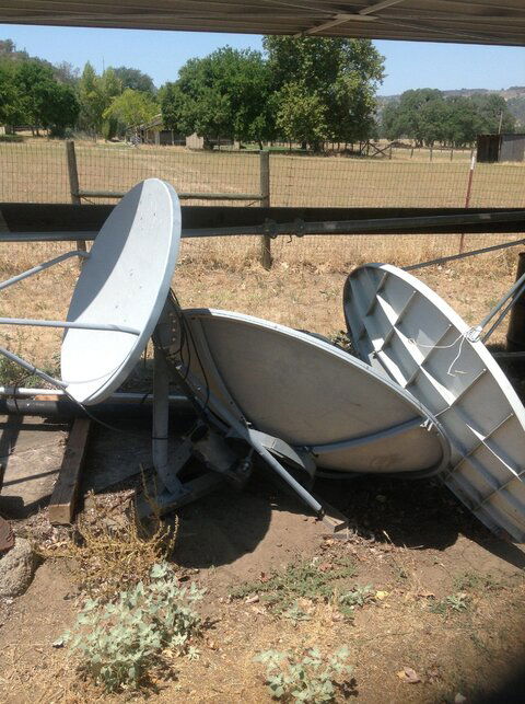

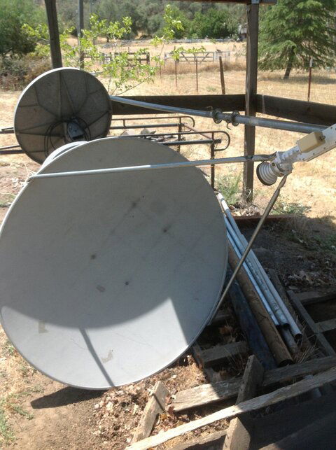

mando209, I did not see your post until today. If you haven't bought that dish yet I've got several I will will make you a deal you can't refuse. I am near Prather, CA. In the foothills but will be glad to meet you in Madera, CAon HWY-99 and bring several dishes for you to look at?
I'll try and get some pictures posted here today, but got company.
Waiting to go to the right person...

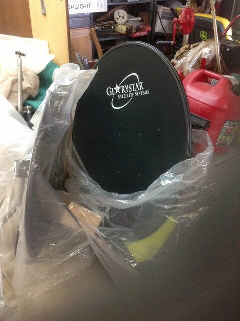

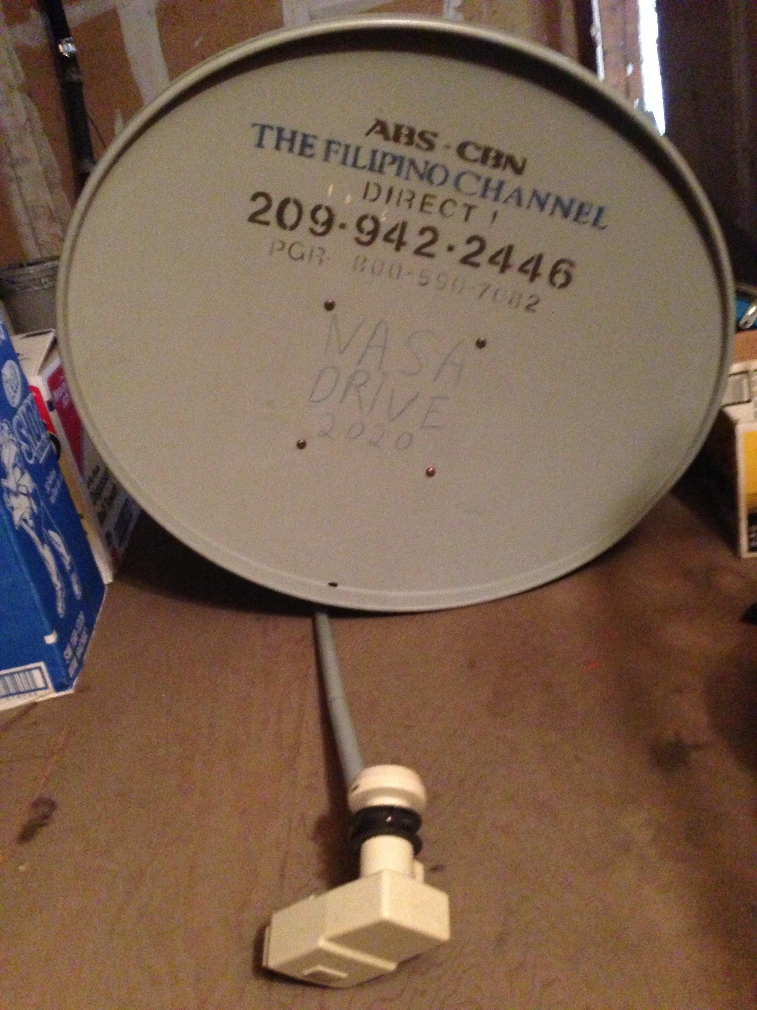

I think Merced is a hr drive from me. Two new Glorystar 33" dishes, a 5 ft CBand solid, and 4 ft KU band solid, and a 36"? ( didn't measure it) channel master I used for demos. Nothing over $50...
been cleaning the place up and hauling away the trash... I'm sure we can make you happy.

Word to the wise
T4Runner has made you a generous offer you can't refuse! :up

The Glorystar dishes will have a bracket to take any general purpose LNBF.
Probably the path of least resistance, and fine for 97 west, fixed.
(even motorized if some day you go that way )
The 36" molded (see the ribs on the back?) Channel Master is also great for fixed operation.
More of a challenge to motorize due to the weight.
If it has original feedhorn and LNB, it would be a no-brainer.
To adapt a general purpose LNBF, would be a bit more work.
