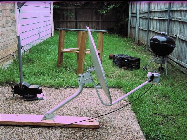

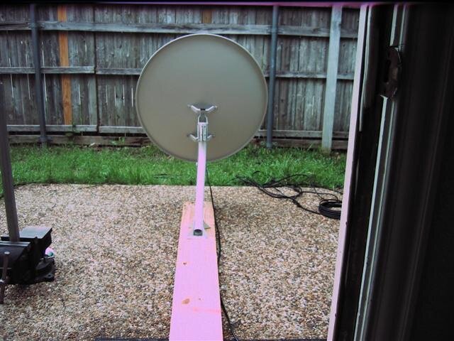

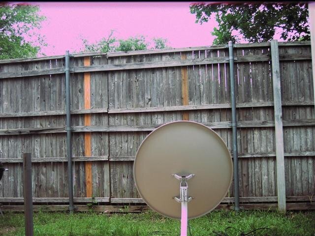

Thank you for all the reply and valuable information in helping a newbie.
I did not have very much time to play around with the dish setup this week. I have posted a few picture on here so you know how my dish is setup outside. My backyard directly faces due south and the sky is open without any large trees obstructing the sky except for my back fence. Any suggestions? Will this setup cause any problems? Do I have to mount it on the back wall?
On the setup menu of the sonic view. Is this value I put in?
Tuner ID - Tuner 1
Satellite - Intelsat AM5
LMB Type - Single
LMB Frequency - 10750
22Khz - off
LNB Power - off
Transponder - 11713
Search Options - All
Network Search - ON
DiSeqC - NONE
Motor - disable
Thank you for all the reply and response.
