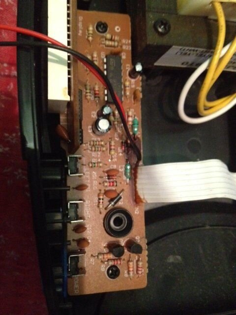

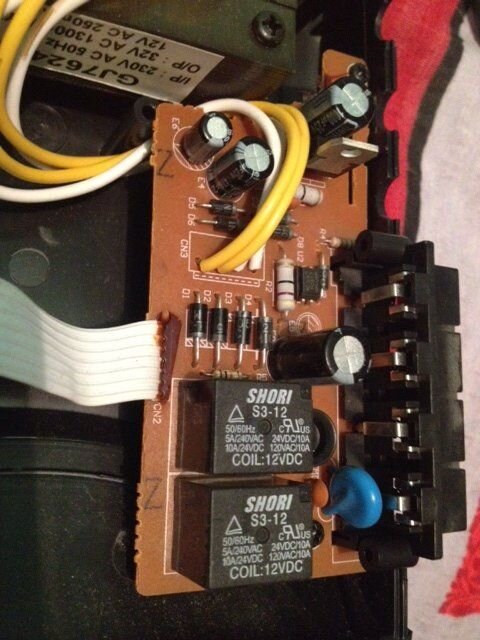

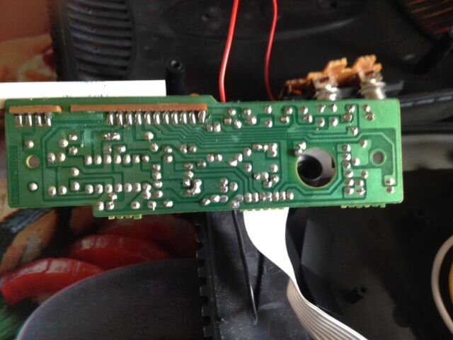

I inspected the boards and it seems ok...
Here are some photos...

Did you examine the solder joints on the bottom of the boards? That is likely where the problem is.
Reactions: beavs2112
Yes...I examined it. It is ok (but I'm not an expert :) )

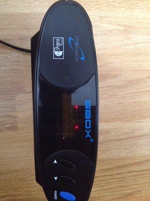

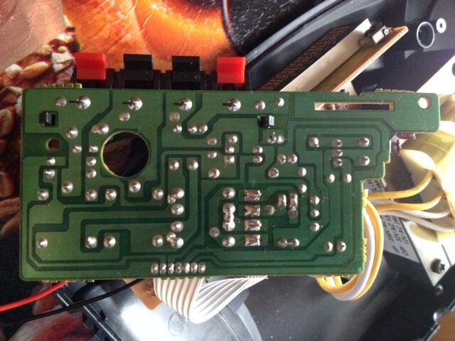

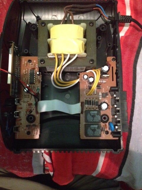

I attached some photos (with boards and bad display)... For me it is hard to find what is wrong because also I do not have the necessary tools to examine it.
thanks

Those you have mentioned are for the 4 wires (2 white and 2 yellow)
Interesting! The reason those 4 are prime candidates is because they are the largest pads on the board. When the board is wave soldered, if the soldering equipment is not setup just right, the largest pads will not get hot enough to form good connections. Board mounted relays and transformers often have this problem. Get a decent wattage soldering pencil redo the soldering. Good luck!
Reactions: luciandan
Also, take a really close look at all connections in the red rectangle.
Especially yellow circle 1 (can't tell from pic but that may not be a good solder joint) and yellow circle 2 (is that solder flux or a damaged trace that may be intermittently contacting the trace next to it). Agree with Cosmo Blatz - resolder anything in question. Good luck!
