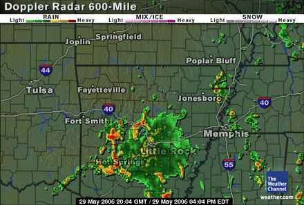

hmmmm...maybe this is why? :D;)
Uplink is in Little Rock
D'uh, that would explain it lol. Thanks Iceberg I should have checked the weather down there.

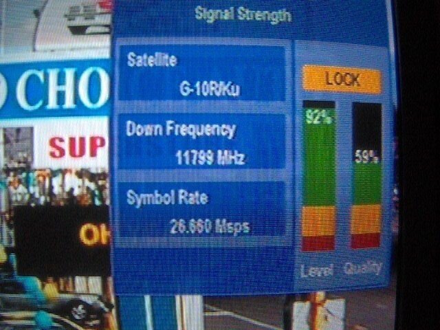

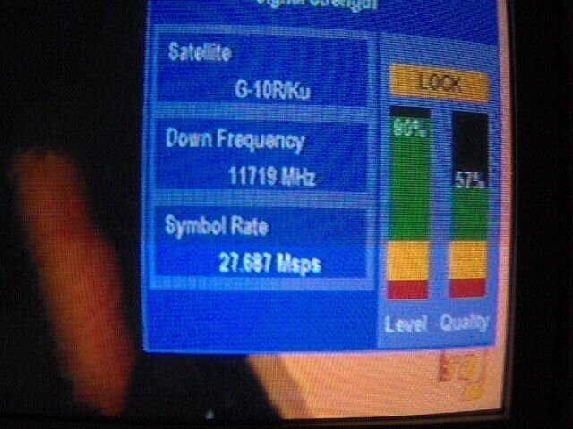

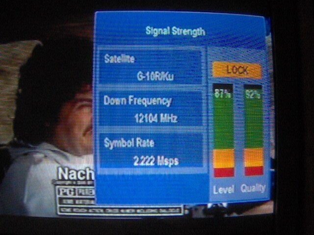

Thats what I'm getting with the 36" dish on G10 :)
(Pansat 1500)
