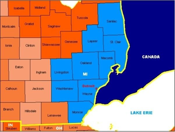

Last map I had for Detroit DMA and surrounding DMAs. Man! That Lansing DMA seems like a huge waste; Clinton, Jackson, Hillsdale, etc counties. Those are the kind that just screw the viewers IMHO. They should just merge with any of the 4 that surround them; notably the Detroit DMA.

THere are parts outside the DMA that are in the spotbeam. The zip code directory lists some as HD available for FSN.
My zip does not, the one next to mine does.
And you'll only get FSD in HD if you get the Detroit locals in HD. That's they way they are doing it. I'm in the Grand Rapids/Kzoo market to the west and our HD locals aren't up yet so no FSD in HD yet.
Only exception is if a game is on channel 95 which is not an MPEG4 channel and thus if you get FSD on 636 then yes, you'll get be able to tune to the HD game on 95. Not so with the MPEG4 channels....yet.

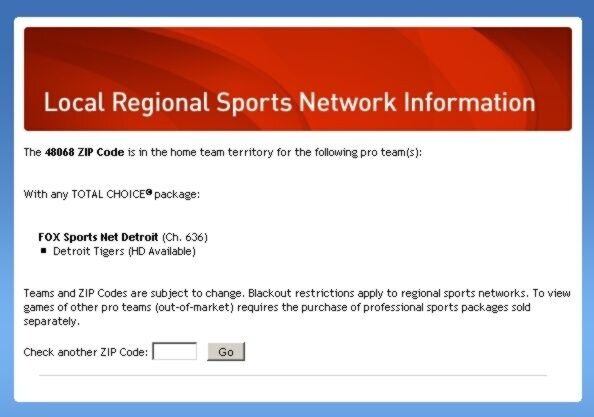

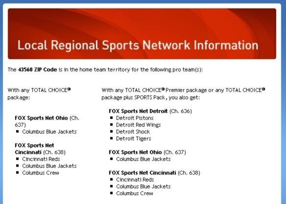

BUT they can cut you off by zip code and you zip does not show to be in the HD data base. There would be (HD Available) next to the teams/channels you can get in HD. See example attachments.

Jimbos, here is the answer:
Check your zip on this DTV link:
http://www.directv.com/DTVAPP/global/contentPageIF.jsp?assetId=P3000004
If the link don't work, go to programming, hd sports, the first 'click here' listed end of second paragraph. Compare your zip to another, like 48843.
See the HD Available, that is your problem. You're probally within view of the spotbeam, but if the HD Available is not next to your RSN/Team, then the channel 96 will not show in the guide.
You could explore 'moving' to an alternate address, but I'm not sure how strict they will be with a brand new install/customer.
My problem was related to my zip code being mistyped by the non-english speaking CSR that took my order. All is well now!
Good luck!
If you are in Lenawee County, MI or Lucas County, OH you will need to find a service address inside the "region" that the DB allows HD access.
