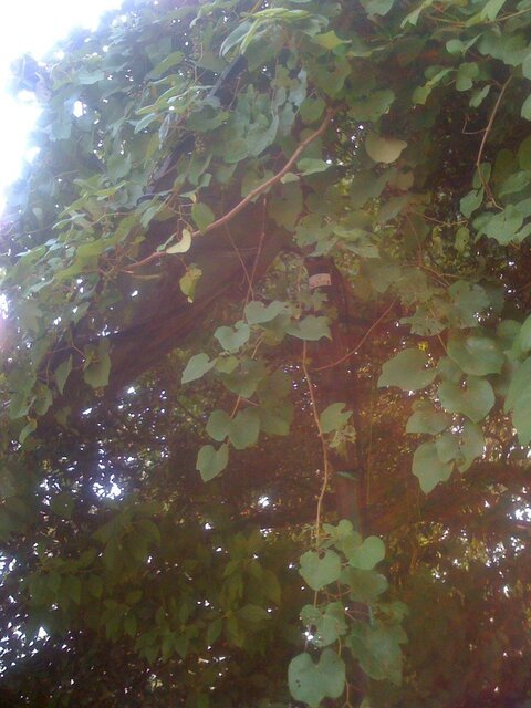

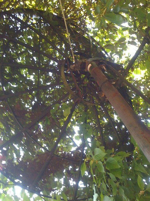

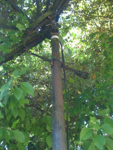

Here she is. :) Looks like it to be a heck of a job, its pretty tall above the ground if i had to guess i would say 10 to 11 ft up, can the panels come off and just be brought down slowly?

If you can use the tree, remove the 4 or 8 bolts that hold the Dish to the Mount, and with a roap over a limb, lower the Dish down as a whole. Then remove the Mount from the pole.

Take a look at the last picture does the mount look bent there? i just noticed that. it has been through 30 years of FL hurricanes, ivan, katrina, and dennis to be the worst i can remember.
be careful with the vines they will hang in the mesh and weave back and forth through the mesh. use a pruner or something to trim them clear.
depending on the owner of the dish if they have no problem with it. use a reciprocating saw and cut the pole close to the ground leaving a bit attached and bend it over slowly. it should ease to the ground
:hatsoff: more good info, thanks george!! owner is cool and actually going to end up doing some IT work from him soon. how much should i leave, an inch? what should i pull with? man power or my yukon:devil:?

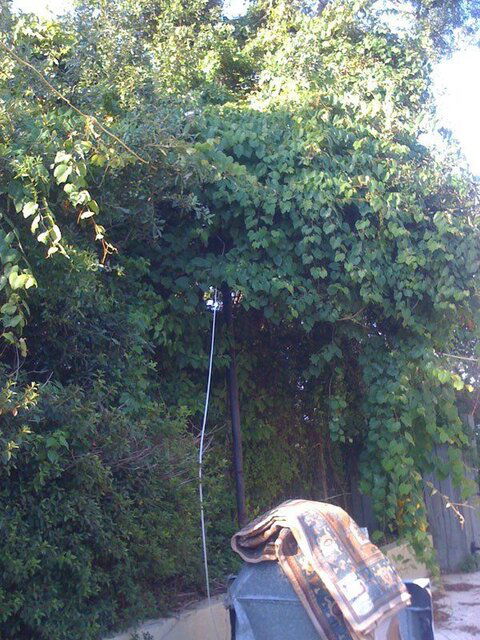

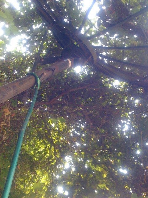

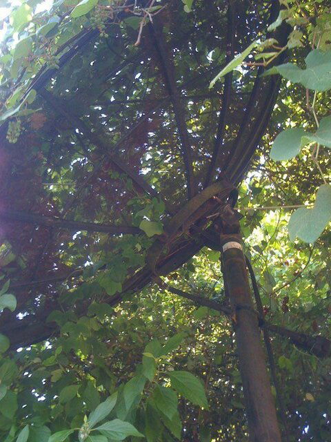

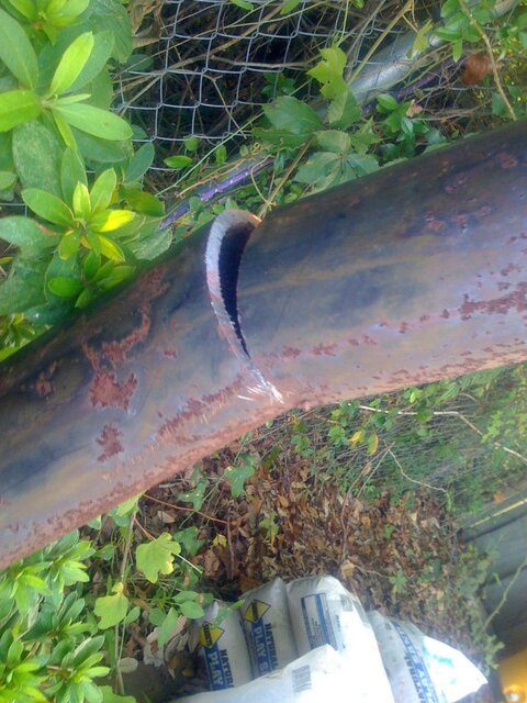

Ok finally got some progress made. Although i couldn't get the vines cut like you all suggested but this is what i got so far. (see attachments) Now everything looks good although i cant get it down because the vines are holding on to the LNB mount. I rocked it back and forth for a while but had to go get in the pool cause anyone from FL knows how hot it was yesterday. So now 2 issues...
1) I got to get it down out of the vines (they are not growing through the mesh
2) There is a hot 120v power cable strung through it going under the lnb and over to a light that comes on at night so basically im going to have to take it apart to get the power cable out.
From looking at your first picture I can see all the over growth that has taken place and is taking over the dish! Did you cut the pole (Middle Image) and then try to pull it down with a garden (last picture) hose?
I hope you are having some help with this to take it down.
The first thing would be is to cut the power to the hot 120v power cable.
Look on the ground and cut the vines at ground level.
Pull each vine one at a time and pull away from dish and feedhord. Wear gloves for this as these vines that grow in Florida have pickers on them, and they will often grow and attached themselves to other vines. Pull all of them out one at a time till all is clear.
Now looking at your middle photo it shows that you cut the pole, so have some help (maybe two besides yourself) there before all thew vines are ripped out to support the dish from falling in a way it could get damaged.
Good luck!
Tom
:D
Its going to be tough to get those vines outa there but i will do my best with help for sure! Only problem with the power cable is its not my house and the cable goes inside the house to connect a big metal halide light outside. So i cant really go in here and cut the power to it. Its a cable in good condition but if i could get it to the ground can i take off an lnb arm and take it out through there?
After looking at the last pictures you posted I sure hope your being careful because I could see how having the pole cut more than half for this project could turn really ugly.. real fast. Once you start cutting the vines, that hose is not going to hold the weight of the dish because being top heavy its going to start leaning and will break the remaining metal... by cutting the pole more than half way you've created yourself a danger to you and anyone helping you.
And having the 120 volt power line makes matters worse...you need to disable that circuit at the breaker box before the dish falls and takes it down, you don't want the circuit to short out.
In my opinion the only safe thing to do is to remove the feedhorn unit, unbolt the dish from the mount and let the pipe and mount drop to the ground. Take some c-clamps and rope and secure the dish from coming down, then cut the other vines dropping the dish, lot easier to handle dish by itself.
