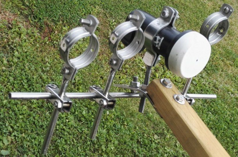

I was thinking a lot about building multifeeds and finally come to the solution as on the attached pictures. It is not so difficult to fabricate and allows to fine-tune each LNB independently. Also, depending on the clamp used any LNBF can be used (neck size 23mm-40mm-65mm). IMG_20170827_121502 (Large).jpg IMG_20170827_121526 (Large).jpg
What clamp and metal brackets are those? I was looking around in Home Depot for something similar and never found it. I was probably in the wrong department.
Many thanks to RimaNTSS! I now have one Geosatpro PLL LNBF and two Inverto Quads set up for 103, 95, and 91. The 95 is slightly misaligned, so it also gets a few channels from 97w, including Press TV which isnice since I'ma bit of a news Junkie.
Now I need to fabricate some better LNB holders so I can squeeze in another LNBF or two... that, and take some photos.

a 3/4" EMT hanger will fit the Inverto quads perfectly and may be usable.
I have to get a couple more pieces, but things are working well so far. The bodies on the quads are still a little wide, but nothing that can't be dealt with.
One more stop at the store and I'll have 103/99/95/91 on a 90cm. Forecast mentioned possible light rain, so I have a temporary rain cover on it until I can add the last lnb. I think my redneck is showing.
Welcome to club with PVC pipe with threaded rods and clamps they hold up a lot better in the harsh weather than plastic holders.
