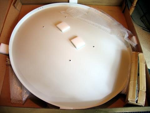

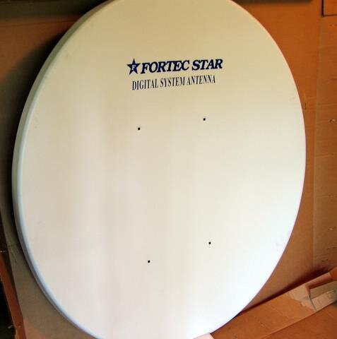

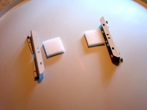

After taking the dish out of the box I lay it face down on the floor to check for true which I found to be exceptional - there was no warpage and no dents or scratches. The steel used for the reflector is 18 gauge and powder-coated for protection against the elements.
The rear brackets which hold the mount onto the reflector are constucted of a much heavier gauge steel which I found to be almost indestructible (As you'll see later).
Two cross-members bolt securely onto the rear of the reflector with a square section connecting the two together which is part of the mounting assembly, this adds rigidity to the reflector and provides a secure mount for the Az/El mount.

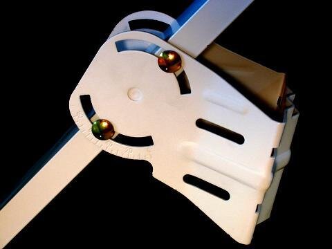

The mount itself is also constructed of the same heavy gauge steel as the cross-members and has the necessary markings for elevation as well as the holes for the provided U-bolts which hold the dish/mount onto a regular positioner or pole of up to 3 inches, in this case I used my trusty DMSI SG2100 which is rated for including, and up to a dish of this size.
My only caveat with the mount is the way the U-bolts slide into the mount holes - you'll need to physically separate the elevation/mount slightly to enable them to slide in, this was no bad thing as it demonstrated the sheer strength of the mount.
After noticing some people had problems with the elevation on some dishes not being able to adjust to a low angle I can safely say this mount will satisfy.
The range of adjustment on the mount is huge and I don't forsee anybody having a problem with low or high elevation settings whatsoever.

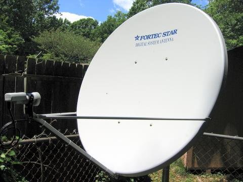

I took the Winegard off the SG2100 ready to be mounted onto another pole and lifted the Fortec into place, this isn't the lightest of dishes so I had to hold the dish up with one arm while I tightened the bolts with my other, the U-Bolts will fit masts of up to 3 inches in diameter and are constructed of hard steel and are more than adequate.
After making sure the dish was square to the positioner I assembled the LNB holder

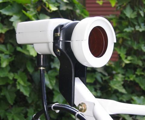

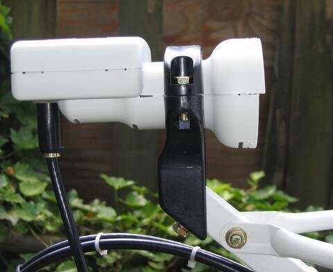

Because the focal length of the dish is longer than a regular 76cm dish the holder has 2 lightweight steel support arms which bolt into place either side of the reflector and again at the end of the LNB arm, again - the bolts used are good quality and ensured a good fit for the whole assembly.
The LNB holder itself is by far the highest quality I've seen, it's made of very thick, moulded plastic which screws into the end of the arm, it also includes a 40mm to 23mm adapter which allows for use of an LNB with a narrow throat.
With everything in place and securely fastened I hooked the motor back up along with the LNB and swung my dish over to Galaxy10R. (The positioner was already set up from when I'd installed the Winegard so I didn't feel the need to adjust it just yet)
I thought the SG2100 may struggle with the weight of the Fortec 120cm however it seemed as fast as ever and didn't falter with the heavier load.
